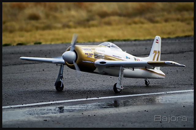

Old 12-14-2015 | 09:31 PM
  #1906
Joined: Dec 2005
Posts: 215
From: tehachapi, CA
trying to post some pics these were taken in oct at chino valley AZ. at an electric fly . Jon Barns took the pics he does awesome work !

Old 12-15-2015 | 04:58 AM
  #1907
Cougar429's Avatar
Joined: Apr 2008
Posts: 1,403
From: Tecumseh, ON, CANADA
Very nice.
