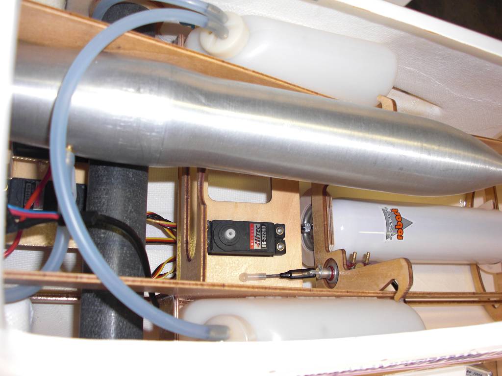

Hey Guys... Yeah, This thing is Pretty much a piece of **** until you make it into something nice... Ive Been Performing mod after mod after mod... From tail to engine.... Its turning out pretty nice though. My Stabilizer Has Brass Reenforced Carbon fiber 1/8 thick tube running the entire length from tip to tip. Also using 4/40 screws to hold them tight against the fuse while the epoxy dries. For Power I am using a BVM 91 Fan Engine.... Im having to go through everything including tearing the wings apart to reenforce them. Then Glass the wings and Paint them. It will be very nice when finished. Yes, Some will Believe that this is way to much work on a 300 dollar Air plane and Yes Thunder tiger should be ashamed of Selling such a Piece of crap to the public not to mention the safety aspect,With that being said... This is a beautiful Air craft and would be a shame not to put the Extra time in it and then Really Admire the fact that you did make it safe to fly and enjoy the plane with out a shadow of a doubt that there would be some kind of Catastrophic Failure in mid air. This is where it pays off to really take ur time and do it RIGHT! Here is some pictures of my Progress... Hope you enjoy!
Old 06-22-2011 | 08:18 PM
  #1656
Joined: Apr 2008
Posts: 95
From: Orange, CA
Default RE: ThunderTiger Rare Bear
Some Pictures...
ID:	1626547   Click image for larger version

Old 06-22-2011 | 08:25 PM
  #1658
bignasdy's Avatar
Posts: 456
Received 4 Likes on 3 Posts
From: TX
looks like that bulckhead is inverted...just sayin. .....

Very nice!clean work....thanks for posting ....

Nexus that looks great nice work that engine looks great too like how you have put the exhaust inside that must have took awhile to plan out. You have just made it hard for me now I had dropped te idea of one of these and stated looking at the Kyosho Kelly F1 now I don't know what to do. I was going to use a V twin 4 stroke I've got a 150 and a 200 V twin but I think the 200 would be over the top and would not give me speed anyway and the 150 not enough. What kind of weight does this thing come out at?

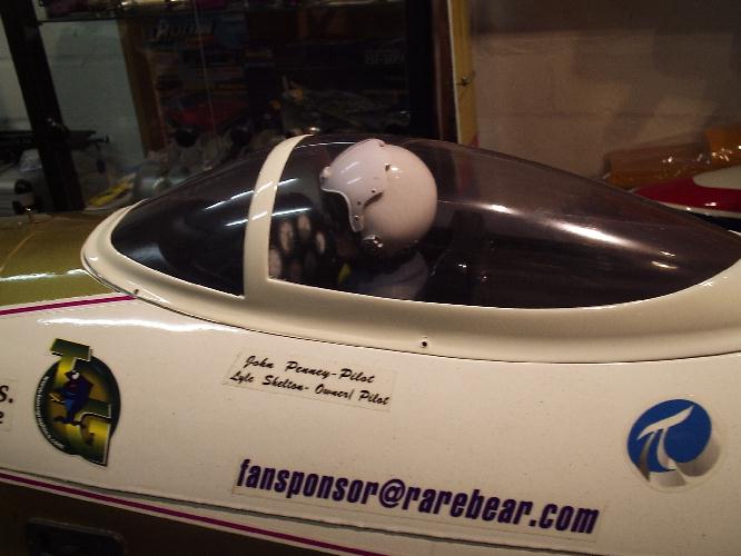

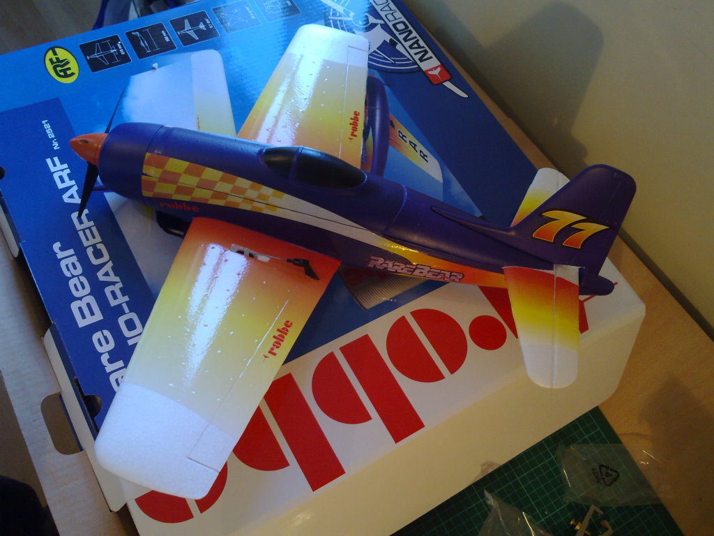

uh nice..... some be loved TT rare bears are still around
hey nexusdc5 very nice build rare bear, i like the bvm set up
let us know how fast it flys
think about the engine loves 10x10 carbon fibre props at 22000+ and the bear has a big bally to hide a small prop ,larger props will heat up the engine a lot.
cooling will be eveything , also for the bvm tuned pipe .
if it gets very hot by an 13x8 you risk a dead stick , be carefull.... safe your nice work and the bear
my bear is waiting for a year now to get maiden with 180 saito with all the modding to fuselarge and wings/stab
and i am still nervous !!!!

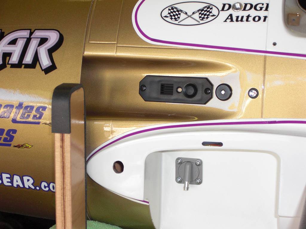

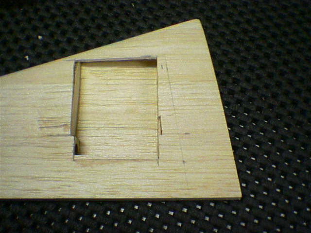

I just ordered one of these, and would like to know if anyone that has installed the servos in the stabilizer itself, has had any flutter problems ?
I have used a few hours reading this thread, and serching google for info, and my conclusion for the flutter and exploding stabs are the internal metal wire elevator torque rods are not up to the job.
I will deffinatly install 2 mini servos in the stabilzer, and seal the gap between the stab and elevator hinge.
Will have to live with a little more lead in the nose to compensate for the extra weight in the tail.

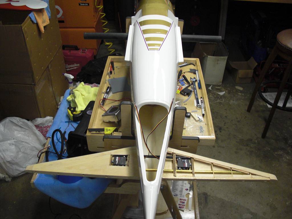

Hey SJN... Yes, Very good Idea installing your servos in the rear wings. That's what I did and they turned out very nice. with that and sealing the hing gap should take care of the Problem. Also don't forget to beef up your rear Wing tubes. I still wouldn't trust the upgraded tubes they provided in these kits. I haven't flown mine yet but still looking forward to the day. Just not finished with it yet.

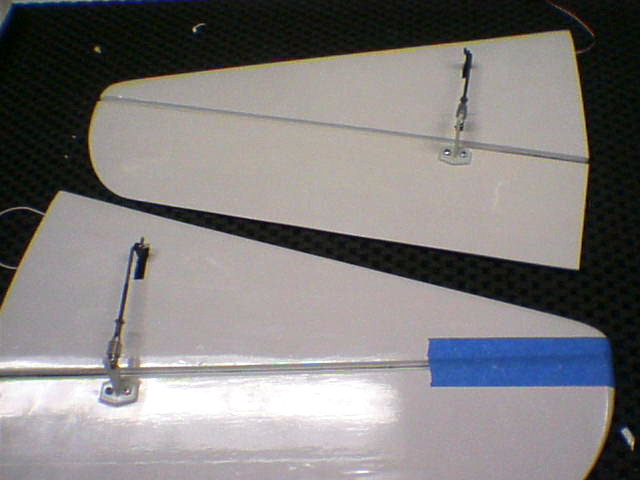

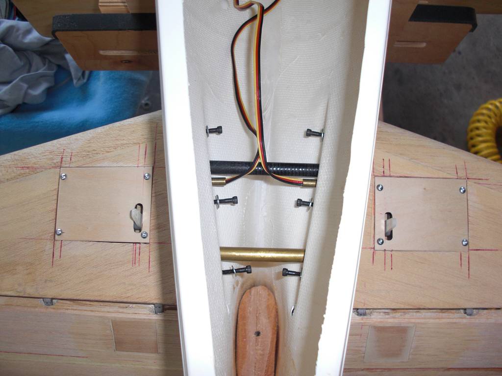

Your setup is extremly nice nexusdc5, and the servo install you did looks great.
I also thought of removing a few mm of material from the trailing edge of the elevator, to get a nice fat squared off trailing edge.
This also delays flutter, and shortening the cord of the elevator will make it a little less sensitive.
I saw on RCG an electric RB which also had the servos in the stab for many flights before he sold the plane.........so at least he did not lose it due to flutter
Here are the pictures I found of his install:
