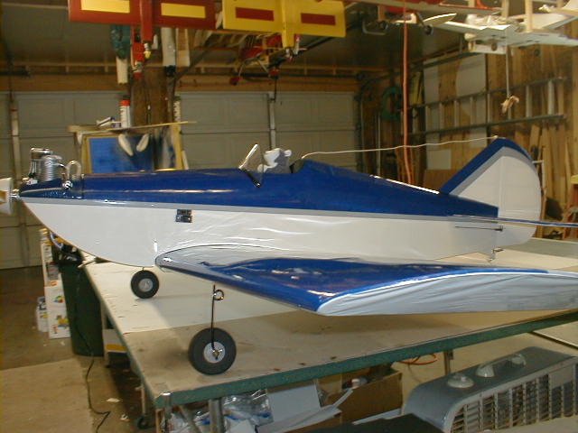

I built this as my second glow plane and flew it alot over the summer before moving up. It is powered by an OS 46 FX. What a great plane, here are some insights I gained from flying it this year. This plane is very capable from goin mild to wild...I know, it is not meant for it but on a tight 1 plane budget you do what you can (plus I love experimenting). As you can see from my pics below, I built it to spite my Michigan loving buddy, and am planning on adding bomb drops next summer to drop buckeyes on the Wolverine flag at the field!
1. Use a 12x4 prop...it will let it slow down alot more for landings and it will hover the plane. I know, its not meant for it, but the brakeing ability (and emergency power) is worth the prop switch alone. It will also knife edge the plane indefinitely...very interesting performance for a slowpoke indeed!
2. WATCH OUT FOR THE LOW RATES...imho the suggested low rates are borderline dangerous. From flying my previous planes, the low rates are like gliders and my first flight it hardly had enough response to come out of any move.
3. When you get bored using high rates as your low ones, set up high rates at about 175%-200% and really have some fun...loops within its own length and yes it will power on flat spin. Outside/Inside loops, unlimited vertical rolls.
4. Watch out flying in the wind. Hardest plane to fly in wind I have had the pleasure to fly...VERY TIPSY. Yes it is fun to fly backwards at 20mph in a 30 mph wind but I only did that once and landing was a huge challenge.
5. Be ready on the throttle at landing in any wind!...i know this goes without saying for all models, but the wind can dump out of those big wings quick in a stall attitude...as well as a little gust can send it soaring skyward again.
6. If you have a mix for throttle/elevator you will be happier...at high speeds that ramp shaped fuselage front requires different trim than at low throttle.
7. If you can, build the kit. By placing servos and other equipment as far forward as possible and building in trim, you can really cut the balancing weight...I only needed 6 oz up front with a 46...I have heard real horror stories about arf's needing almost 1 lb.
8. Make up some stickers that say U CAN POKE 3D...and slap em on it. I almost have my wife talked into gettin me an airbrush for Christmas so I can!
Side View
Top View
Enjoy this great plane!
