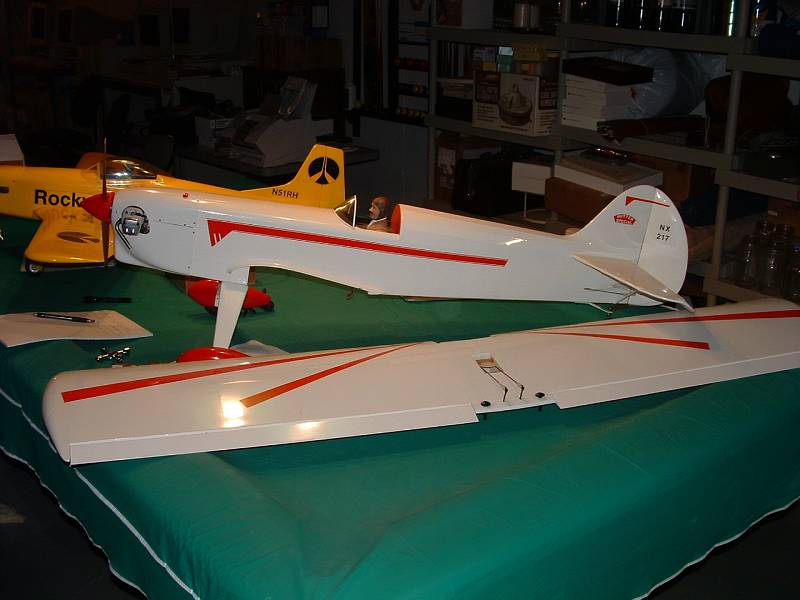

I kind of thought the Nuttin' Special became the Dragon Lady ARC which is now the Dragon Lady ARF. I have the Dragon lady ARC. Does this look anything like it??

Have the Dragon Lady also, the "nuttin special" has a fuse that is quite a bit taller and a little narrower with a fiberglass cowl to match. The 1.08 is inverted because of the narrow cowl but fits nice. I added a "cheek" to the side of the cowl for cooling air for the pitts style muffler. The planes otherwise are almost identical with the exception that the tail feathers on the "nuttin special" are built-up as opposed to planks. Hope to have pictures soon. Thanks for your reply and happy flying. BDane
