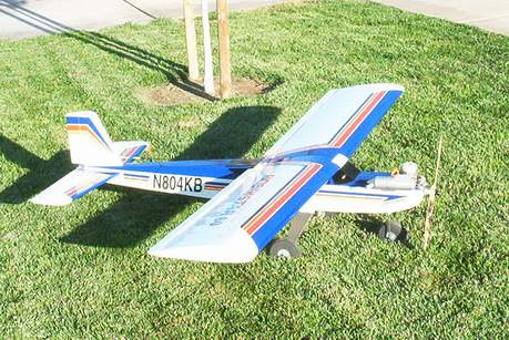

I mounted and flew a Magnum 120 two stroke on a Hobbistar 60. I relocated the battery near the rear in order for the plane to CG right. I made a trap door for battery access for final positioning. The plane flew like a rock though, it was just too much weight for the wing loading. The front landing gear was to weak for the weight (should of went tail dragger), and the LARGE tires were needed for prop clearance.... hee hee
Yup, it had unlimited vertical.
