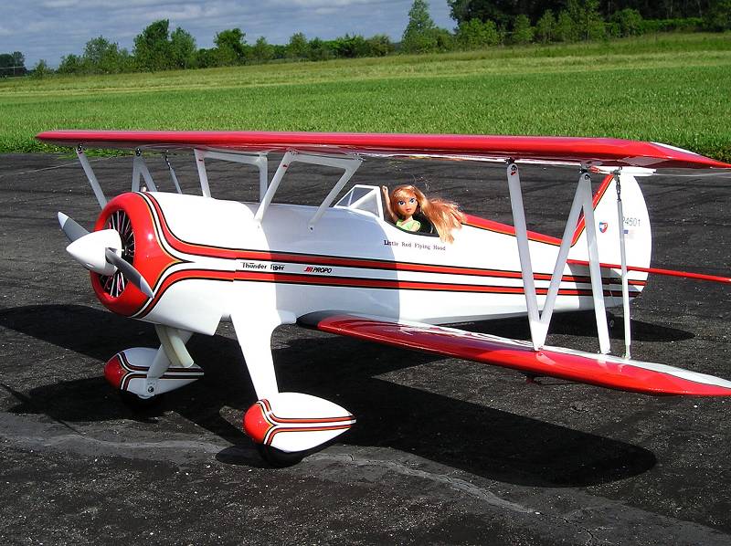

"Little Red Flying Hood"
13 pounds 14 ounces, includes 7.5 ounces mounted to the engine mount
Thunder Tiger 1.27 two-stroke-cycle
SonicTronics 310 plug
Bisson Muff
5% fuel
17 x 6 APC
4" Top Flite Spinner
Hitec 475 servos
Will move servos forward to reduce added weight.
Upper ailerons adjusted 1/4" upward at the TE when at neutral (lower ailerons are centered.)
No loose screws for wing mounting!

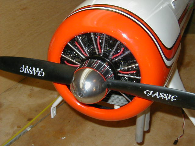

Do any of you have pictures of a completed Stearman nose with the Tru-Turn 2-3/4" spinner mounted? If so, can you please post a couple pictures for me. Thanks.

Here you go Ham!

Thanks. Does it look like its a little oversized for the airplane once its mounted or isn't it too bad
