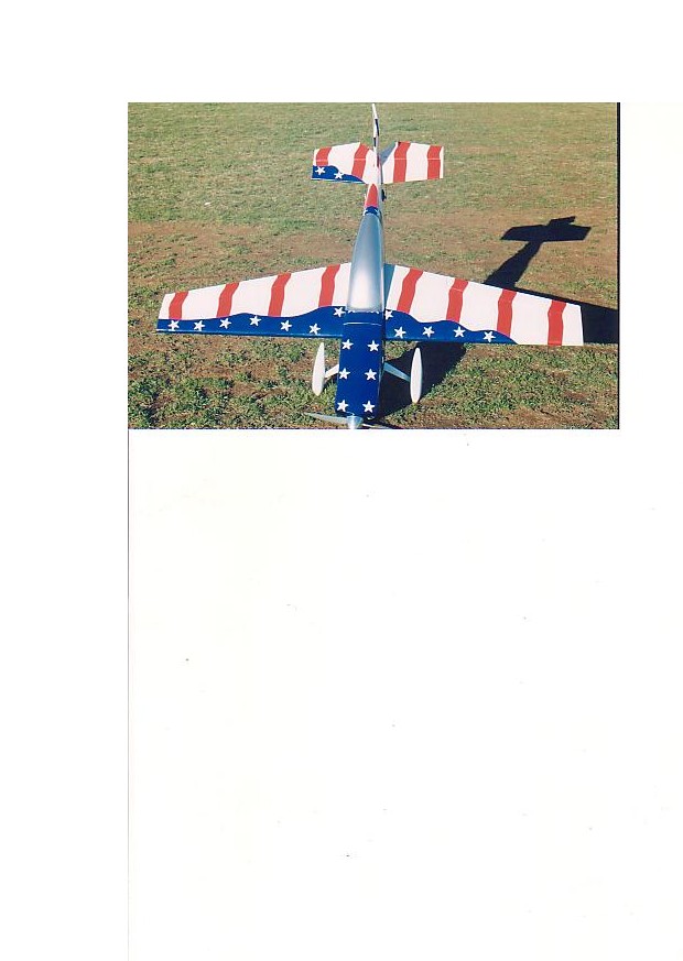

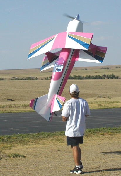

i have a 150 in a cmpro edge and came out at 10.5lbs
it pulls it around pretty good with a 16x8 apc but, i wish i had put a 180 in it now.not much difference in price and the 180 has heaps of grunt.
i have a 180 in a modeltech ultimate it weighs about 11.5lbs and has heaps of power.

sorry wrong pic of ultimate.
