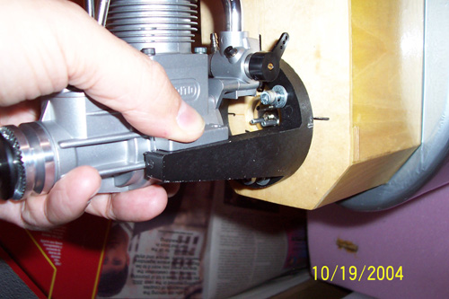

I am thinking of purchasing the STA - M .
While doing some research I came an review in RC Report by Dick Pettit, regarding the high tank position. He was concerned and call GP they stated it worked well in there test. He went ahead with building and experinced no problems with the tanks.
Did they change the position on the M model ? Is this a problem I should watch out for or go with a pumped engine ?
Old 10-19-2004 | 04:14 PM
Joined: Feb 2003
Posts: 1,244
From: Toronto, ON, CANADA
Default RE: GP Ryan STA
I'm just building one so I'll take a pic of tank position and post it a bit later for your inspection.
Old 10-19-2004 | 04:43 PM
Joined: Feb 2003
Posts: 1,244
This is the STA-M.
Note that the tank pipes are just below the carb line (this is a Saito 100 and unpumped). Keeping in mind the pic is upside down (or rather, the plane is), when in flight the centre of the tank will be slightly above the carb but still generally in the middle of the tank. Not a problem as far as I can see.
Other posts suggest unpumped is not a problem either.

Old 10-19-2004 | 08:26 PM
LMProd's Avatar
Posts: 288
From: Woodland Hills , CA
voyager
Thanks for the quick responce and photo. Looks like it will be a fun project and plane to fly around.
