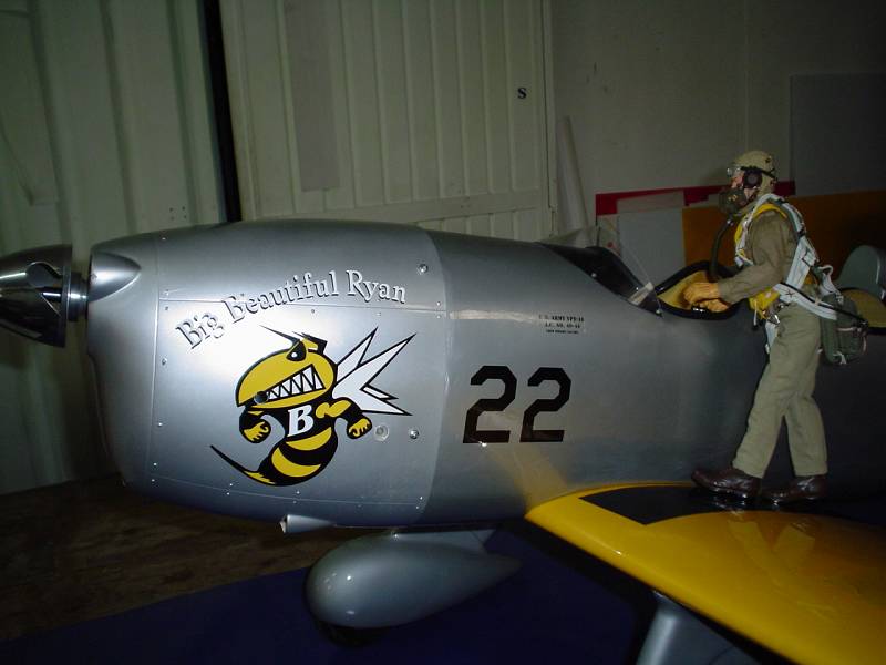

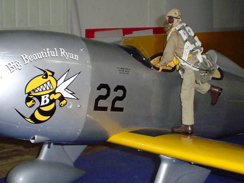

Joined: Mar 2005
Posts: 151
From: monterrey nuevo leon, MEXICO
Default RE: GP Ryan STA
i had a good time reading,
thanks
marcelo gonzalez
MEXICO[&:]
ID:	518867   Click image for larger version
ID:	518868   Click image for larger version
ID:	518869   Click image for larger version
