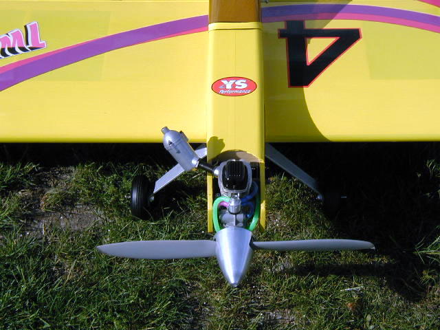

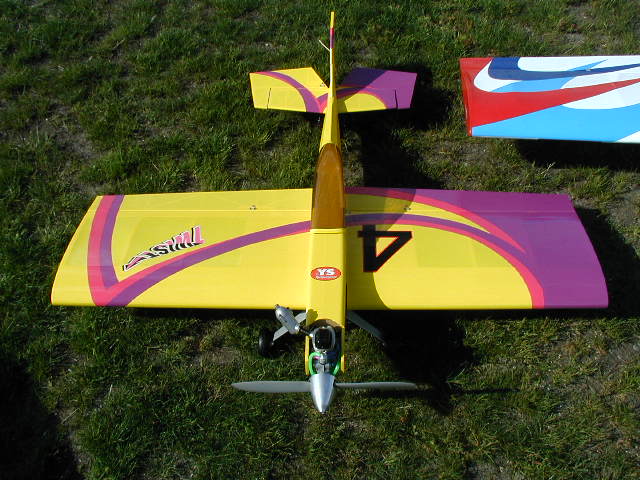

I used a YS 63s with a APC 14x4 prop ...This is a Great combo ...I did add about 2 deg right thrust ...I hard mounted the engine last ,this aloud me to move the engine for or aft to get the balance just right ...with the CG @ 4 1/2" and the engine all the way to the front of the mount it didn't need any penalty weight ....JW
