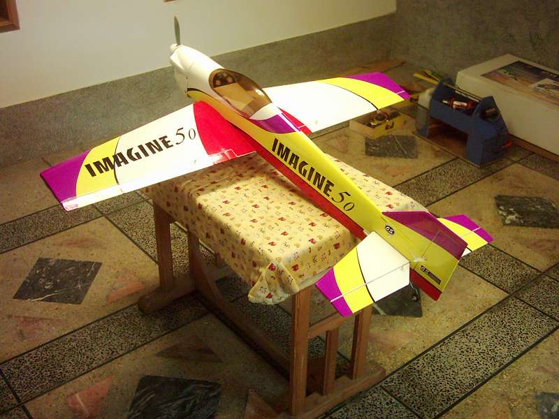

Its a beautiful looking aircraft....I have one with an O.S 50 SX ringed.....havent test flown it yet coz I have other planes that I am flying these days but I hope it will be a great fying aircraft.....Here is the pic of my imagine.....If you have any questions about the kit biulding feel free to ask.....my email [email protected]

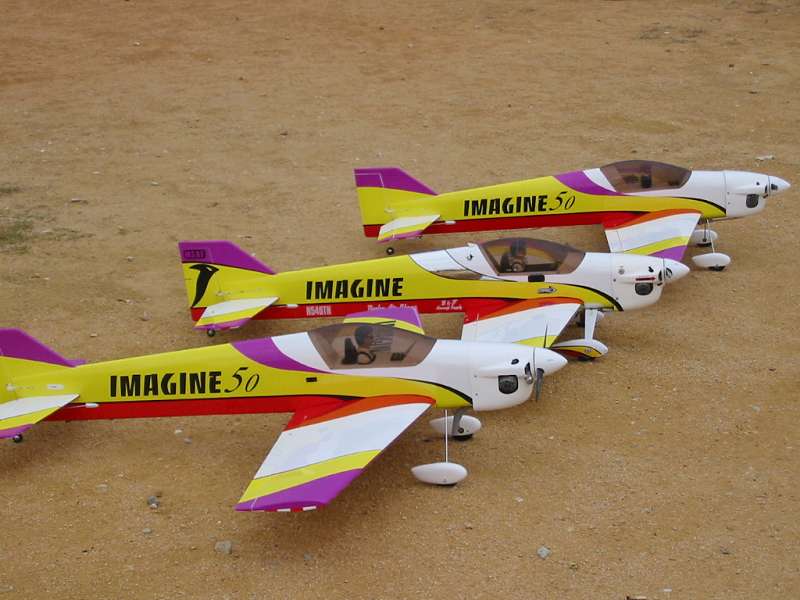

No, it's not a 3D plane. It's a pattern.
Here's 3 of them at our field. Mine's in the middle.
