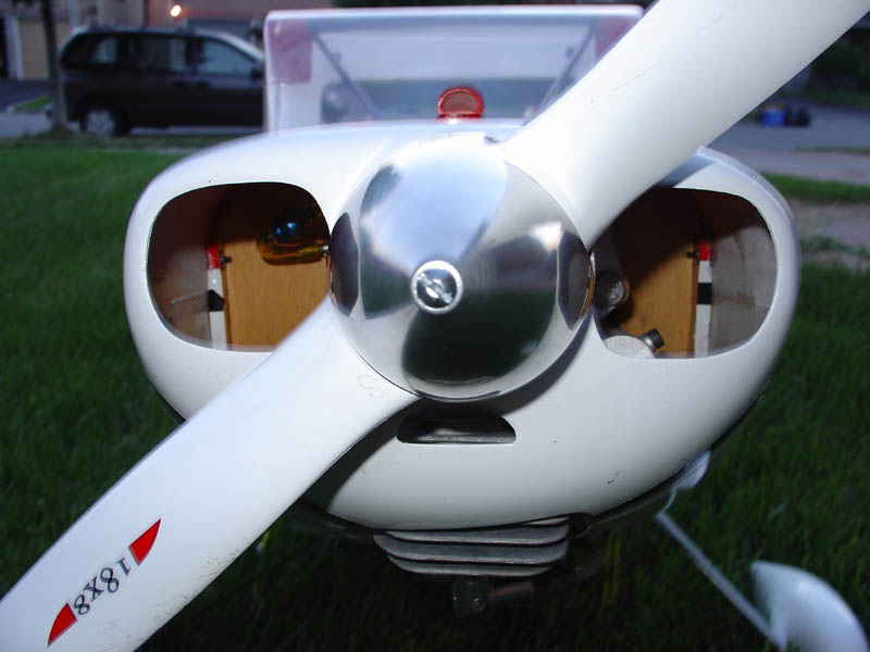

Default RE: G26 in H9 Taylorcraft
I have one with a 3W-24 in it, and it pulls it nicely.
