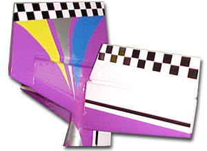

#87
Joined: Aug 2002
Posts: 214
From: Franklin,
TN
I can't speak for "normal" assembly as I've been dragging on mine forever but as for the assembly process - great directions and it actually works like they say.
I was lucky to have the aluminum-braced firewall so I didn't have to modify that. I did glass my wings together (wishing they were tubed though
One thing that caused me to drag on time is that I rebuilt the rudder and elevator(s). One thing I read about the Sig was that while it was awesome at IMAC stuff, it lacked a little surface area for 3D stuff. I already had the Extra or I may have considered the 231. So, I rebuilt the rudder and elevators.
I'm also adding color to the design so that's another contributor to the time thing. I wish the purple color was deeper purple like you see in most of the advertisements. This color is cool, but I prefer the deep metallic plumb rather than this brighter purple.
-shaun

#88
My Feedback: (67)
Posts: 1,381
From: NORTHWOOD,
IA
Hello SIG EXTRA 300XS owners,
Hay Smartwork,
Good mod job on the tail feathers.My Extra's is still in kit form too.Im in the proceed of getting all the engine and radio gear and servo's right now.
Can't decide if I want to go with a 1.20 size or put the OS BX-1 2 stroke in it.
Im like you I like the darker plum purple and Im debaiting while mines in the kit form I may take off the puple that on it and replace it with the darker plum color.
Can you give me the mesurements on your modification. I may do the same.
NEDYOB
Hay Smartwork,
NEDYOB

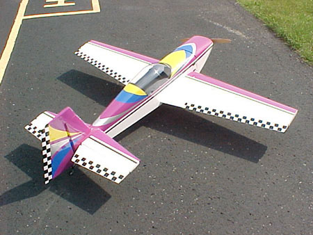

#89
Joined: Aug 2002
Posts: 214
From: Franklin,
TN
Well, after taking WAY too long on this model, it finally had its first flight today after going through ground clearance for teting for no RF bleeding from the ingnition... whew!
Sig 300XS
2.4 Brison
20x8 Zinger
wings glassed together
modified covering
S9404 on rudder
S9202s on all other surfaces
148 on throttle
miracle Y on 1 elevator servo
dual Hitech Supreme 8 receivers - split plane down the middle
2 1150 ma NiCd batteries for receivers
1 1150 ma NiCd battery for ignition
built new rudder and elevators from scratch - enlarged all
installed choke lever through cowel
drilled cowel for easy high/low adjustment
3 charge switches/charge jacks installed in fuselage side
quick fueler for gas in fuselage side
Flights today went great. Going to fine tune the engine a little more for the mid transition. Seems I have great low and high, but the mid seems a little rough during transition. After all my hashing out about which prop to use, I started with the 20x8 Zinger and it has great vertical and I suppose even more once the engine runs in more and we get the adjustments tweaked just right. The engine is used but just a few hours on it. About 7400 rpms with the 20x8. I've seen 7300 posted here as the recommended but checked Brison info and read 7500, so everything looks cool.
After all the reading, I was sure to keep those couple clicks of throttle during landing and it was just right with the wind we had today. It settled in really nicely.
One thing I will change though is the spring set-up for the tail wheel. Way too weak. I'll either beef up to strong springs or I'll link them directly with rods. Gets a litle flimsy for runway steering.
That's about it for the initial report!

#90
My Feedback: (19)
Say, smartwork. Your plane looks great. Congrats on those first flights. Do you know exactly where you're at on weight for that plane? I fly mine on a Moki 1.8 and it accurately weighs 13lbs 14 oz. It flies great.
My mods were tiny. The ailerons needed a little bit of differential for this plane to roll axially. The engine box/firewall has no right thrust and it needs it . I added a couple degrees of right thrust by shimming up the leaft side of my MOKI's radial engine mount. It could use a little more but I'm not going to add it right now. I bought carbon fiber landing gear from GraphTech for a full six ounce weight savings over the stock aluminum gear. And I scrapped the quarter scale pilot figure I had in there. His heavy head weighed a whopping five ounces.
Now the plane flies GREAT. Very smooth, easy takeoff and real easy to land, even on our very very small field.
-Cheech
