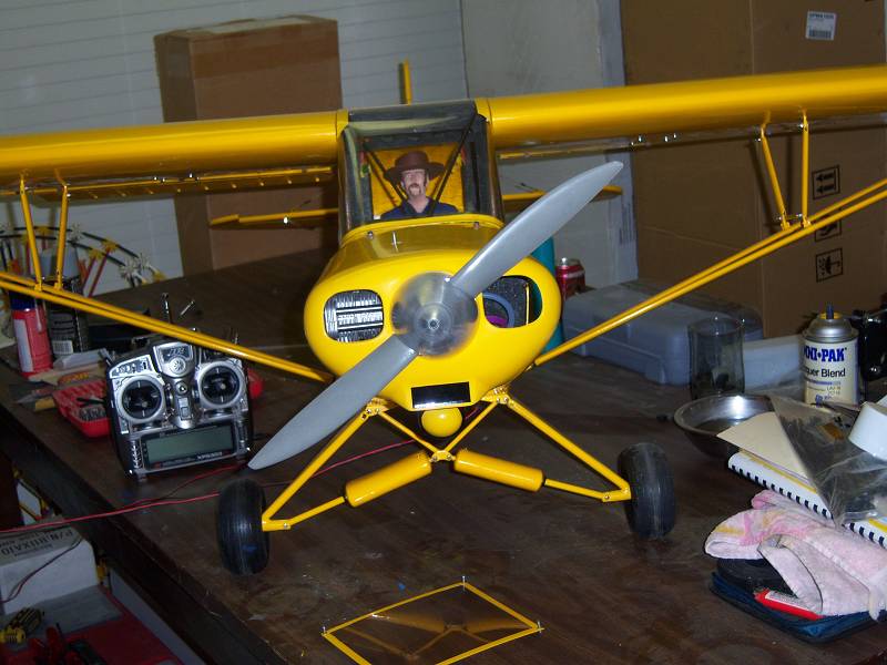

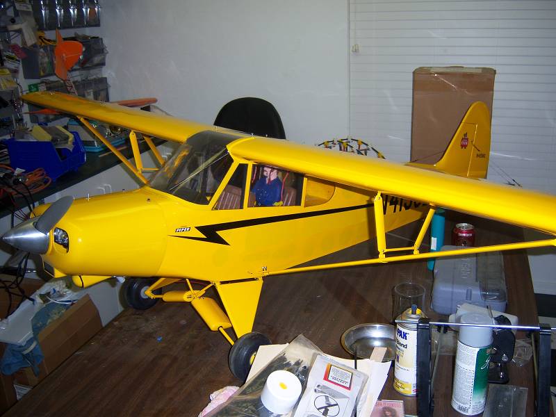

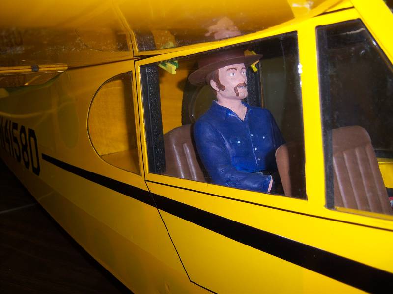

Here's a couple photos. Sorry for the dirty shop.
Dan

Looking good, Dan. Should fly like a dream.
Again, good luck on the maiden. Wish I could be there to witness.

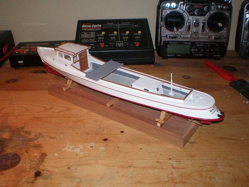

Hey Mark,
I'll keep the float thing in mind, the fittings were built especially for the DPM cub. I see I have competition since H9 came out with 1/4 scale floats that will be a whole lot cheaper than I could sell mine for. I may not be able to sell the plane as I won't ship. Local p/u only. I am a lifetime modeler and health is part of my quitting but I'm going back to my roots of hanging around the Chesapeake bay and building scale boat models of the old oyster boats and crabbing boats I grew up with. Just had sudden burnout and tired of lugging everything heavy to the field at my age. A trip to the Maritime museum at St Michaels Md brought back some memories that makes the modeling switchover easy. I apoligize for a boat picture in a cub forum but this is what it's all about for me.

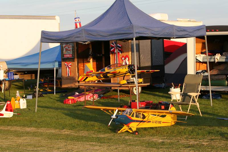

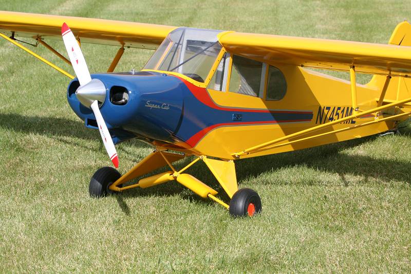

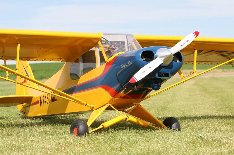

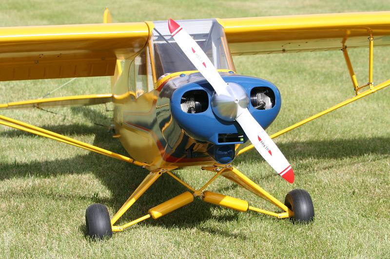

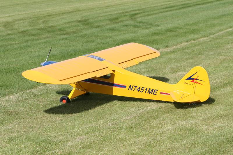

I am happy to report that my Cub still looks like these pics after it's maiden flight this past weekend. I balanced level instead of the customary nose down attitude and my elevator is kind of touchy. I set it up according to the book and found myself comfortable with the high rates for normal flying. I haven't yet set up the exponential, but think I might need it on the elevator if changing the CG dosen't help. It might be a tad tail heavy.
I'm running an OS 160 twin fs for power with a Keleo exhaust system. I ripped all that Ultracote off, added a lighting system from Electro Dynamics (EDR117) and then recovered with Sig Koverall. The paint is Randolph butyrate dope applied like the full size counterpart. It took me a while to do, but now I have a drum tight, no wrinkle finish that is easy to maintain.
Overall, I am very happy with the results of my labor.

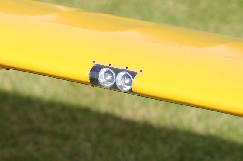

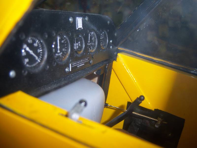

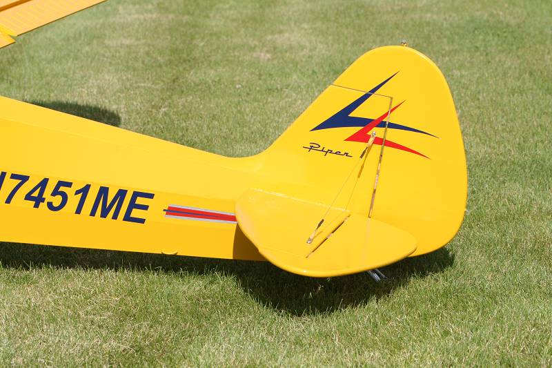

Here are a few more pics.
I made the landing lights by using Maglite reflectors. I had to reinforce behind my cutout in the wing leading edge with plywood. Then the old pop bottle plastic lens after the finish.
I also replaced the tail wheel assembly with a medium Sig unit like comes with the Rascal 110. I couldn't get the stock one to work right as it is too short and tight.
I'm running the Fromeco lithium ion 2600 battery pack regulated and a Badger switch. You can fly all day on a charge.

Very nice! Your plane looks like the full scale aircraft. Your work has paid off!

Thanks, Outacontrol41. I looked long and hard for a paint scheme on the Airliners.net site and couldn't find anything that turned my crank. I wanted something different than the usual, so I did my own thing. I do have a mixture of ideas from there. I was trying to not have to repaint all the yellow hardware. As it turned out, I just had to do the cowl, flaps and ailerons.
