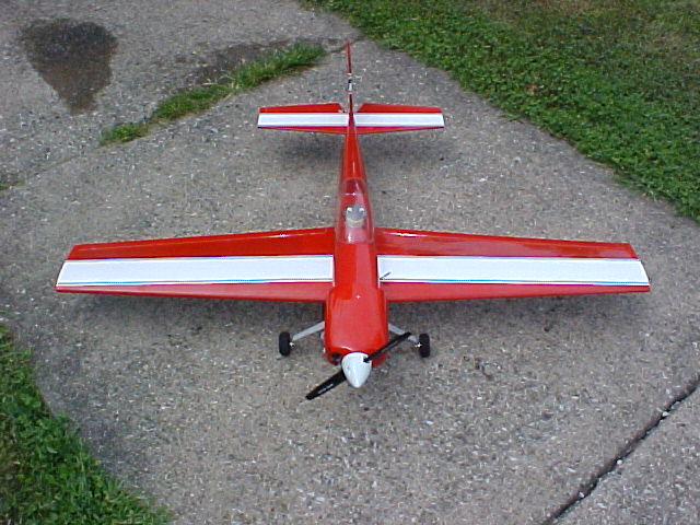

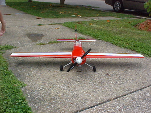

I just finished this ARF and thought I would share the photo's. I would highly recommend to anybody building this plane that you replace the wing bolts with nylon bolts. I installed the blind nuts and small metal screws that came with the kit. Well, one of the blind nuts came loose and I ended up having to drill the head of the screw off to remove the wing.
I installed a Magnum .36 with a MA 10x5 prop. Maiden flight is tonight. I hope it stays in one piece.

Great Success! This plane is a rocket! I was flying the plane at 1/4 throttle and it is awesome. This is my first tail dragger and oh man what an experience. This 300 did not have any bad tendencies at any speed. It performed level flight flawlessly. The plane does not lose speed very fast, So it tends to land hot.
This is a great little plane.
