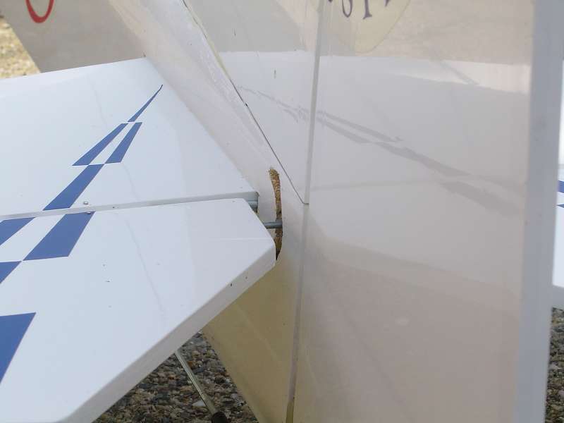

hi, i have a question, has anyone had a problem with the elevator being flaky, when i pull back on mine, the plane acts like, starts to pull up and pauses then goes into a weird kind of turn, i replaced the servo with a new 100 oz. one and the same thing happens, it seems as though the elevator may not be flat totally and i think that would make the plane turn out on pulling back, but would it give it the delay feeling thing, any help would be awesome, i have checked the radio all out and linkage is perfect with no flex, thanks jb

i had it up again this morning and with my elevator at only approx 3/4 inch throw doing a mild pull back like you wanted to climb at a 45 degree angle at 40% throttle it almost does a kinda barrel roll to the right when you pull it back,?? i thought my elevator was kinda flexy< (new word), so i added some support on both sides also, thanksjb

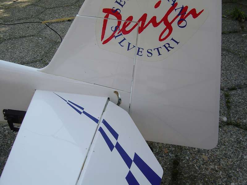

Hi JB,
I think that under the load one off the elevator-halves is being pushed down more so it starts to roll.
While building mine I also found the elevator very flexy, so I decided to stiffen up the elevator-halves by putting an extra steel rod between them.
Better look at the pictures to see what I mean.
Robert

that is a great idea, i will try and figure out the best way to do that tonight, thanks jb

While the above mod may look like a good idea, it's not necessary on this plane. I have one with the elevators assembled stock, no problems. There has to be something else causing the condition you describe.
