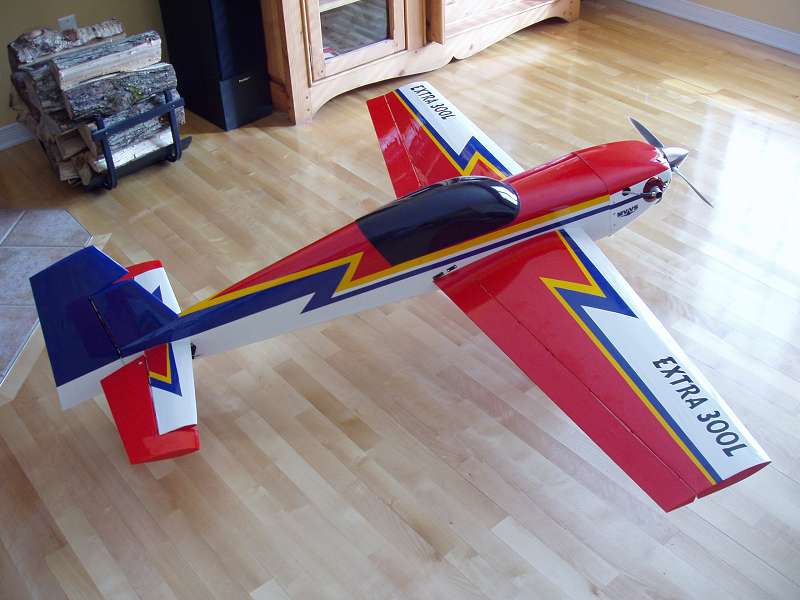

My MVVS1.6 hovers my fat (12lbs) 24% CA Extra300L at full throttle, Menz s 17x8, 8100RPM. That's the best prop to practice IMAC. I have unlimited vertical with Menz S 18x6 at 7900RPM and 3D stuff.
I am using an incowl Bisson Pitt muffler.
My flying buddy is flying a light CaP- 232 at 10-11 lbs, 72'' and OS160FX. He has unlimited vertical at half throttle. He flies 3 flights and come back to home, 1/2 gallon glow burned. He broke the fuse last weekend in two parts. That's the cost for overpowered plane...

Keep it light and you'll enjoy it. 13lbs is heavy for the MVVS1.6 and Bisson muffler. I would not recommend it without tuned pipe in aerobatic plane to get descent performances. With the tuned pipe on the MVVS1.6, you will get over 8000RPM with a Menz S 18x8.
I have found the best MVVS1.6-aerobatic plane combo is the 2m Funtana pro. That plane has already a tunel to fit the pipe under the fuse. You can do 3D all day long with 1.5 thrust/weight ratio.
My extra 300 has a MK bellcrank on the elevator, so, only one JR8411 instead of two servos.
