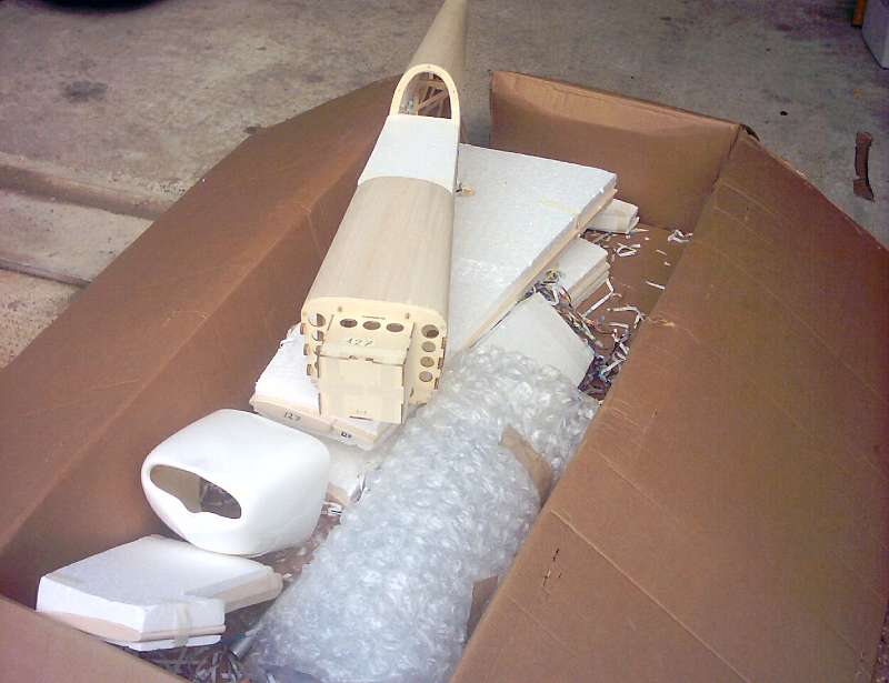

Well, here goes my effort at a build thread.....
I ordered a CA extra (24%) from Planes Plus for a "Cant refuse" deal (returned/damaged).
After ordering the plane (almost ready to cover), I started doing some research in the forums. I found that the 24% version was coming out way tailheavy when built by the numbers. The wing area was not as large as expected as well (approx. 880 sq.?). Reports were that it tracked very well (long fuse) but was no 3D machine. My plan then was to keep the plane as light as possible and at all costs, make sure I wouldn't have to add nose wieght.
Here is how it came in the box on June 22nd.

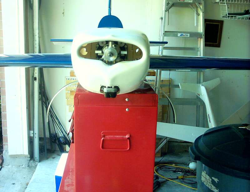

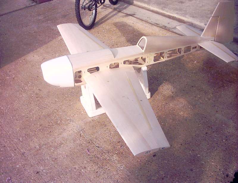

Here is what it looked like 10 minutes later....very encouraging....I weighed the airframe just as is in the picture - 5lbs. 1oz.

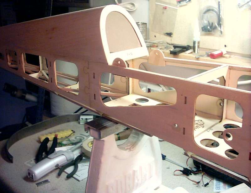

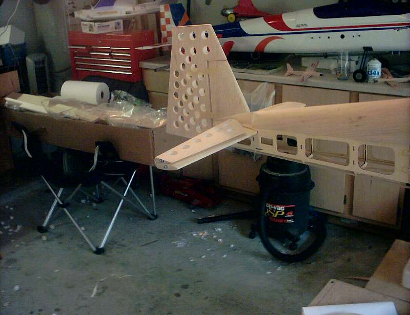

By reading the forums, I realized that I had to extract any amount of grams that I could from that loooooonnnnng tail moment. "Mr. Rudder, I want to introduce you to my little friend, Mr. Hole Saw."
After swiss cheesing the rudder as much as I dared (doing the twist test after every few holes), I went after the elevators as well. With the elevators I was much more conservative and I did not break through the top balsa skin. After the hole saw treatment, the total weight difference was right at 2.0 oz. Not bad really, since the that 2oz. was soooooo far from the cg....about 4X's as far as the firewall to the cg....which would equal about 8oz. of nose wieght.

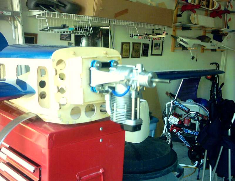

Old 08-11-2004 | 11:43 PM
flyintexan's Avatar
Joined: Apr 2003
Posts: 1,207
Received 2 Likes on 1 Post
From: tomball, TX
Default RE: CA 24% extra - ARC

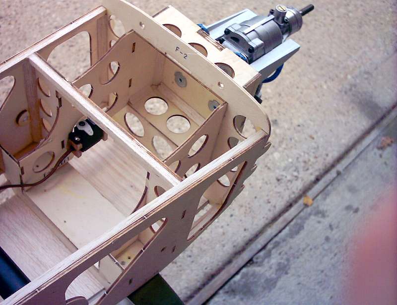

The motor box comes simply taped together. It's up to you how you go about centering the motor to the cowling, and how to get the distance out to the front of the cowl right. My buddy brought over his new laser level (wide beam for mounting shelves, etc.) and we established a position on the firewall. These new household lasers are fantastic for model building. Anyway, after cutting the motor box back about 1.75", I had the distance close for my YS140sport. Here is a very poor picture of the mounted YS motor....and in the cowl...

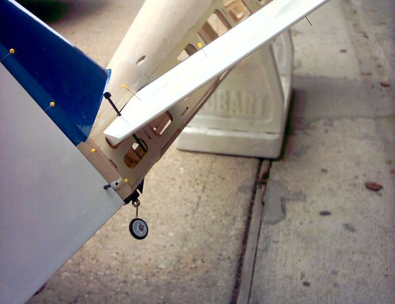

Old 08-11-2004 | 11:51 PM
flyintexan's Avatar
Joined: Apr 2003
Posts: 1,207
From: tomball, TX
You will notice, the fuse is not covered yet....(about Aug. 1st). I was undecided about how I was going to run control linkage to the elevators. The rudder would of course be pull/pull. After some debate, the lightest setup for the elevator would be pull/pull as well to a good, high torque, coreless servo in the fuse, near the cg. This servo is mounted on its side up high in the fuse...to be in line with the stab. The rudder servo position was moved forward, closer to the wing tube. The throttle servo found a home near the firewall.

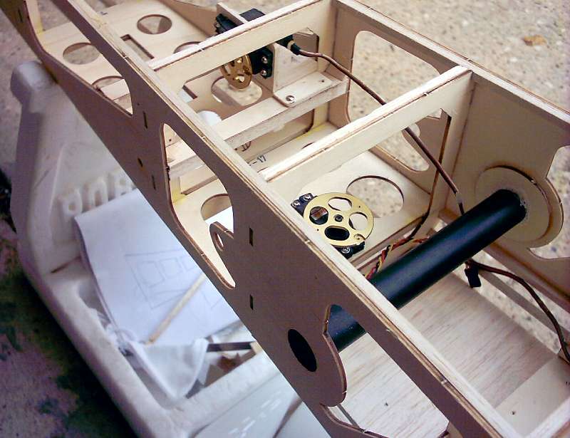

Old 08-12-2004 | 12:01 AM
flyintexan's Avatar
Joined: Apr 2003
Posts: 1,207
From: tomball, TX
After mounting the servos, I had to then run the pull/pull exit locations. This where the laser level again saved the day. We taped/marked the position of the laser from the servo arm, to the location of the control horn looking down on top of the fuse. Then marked with tape with a laser line from the side. Where the two pieces of taped crossed, was where the exit of the pull/pull line would be. Very accurate and simple. Note, the pins in the picture are to keep my ca hinges centered. I also use carbon fiber rod for my control horns (thank you Nat Penton). I drilled an 1/8" hole (carefully) straight through a hardwood dowel hardpoint and ca or epoxy it in place. The nylon eyelets can be ca'd onto the rod later when the linkage and throw is set to my liking. Also note the MK tailwheel....very light. I also drilled some lightening holes in the tailwheel plate as it was very large and thick (1/4", 7 ply).

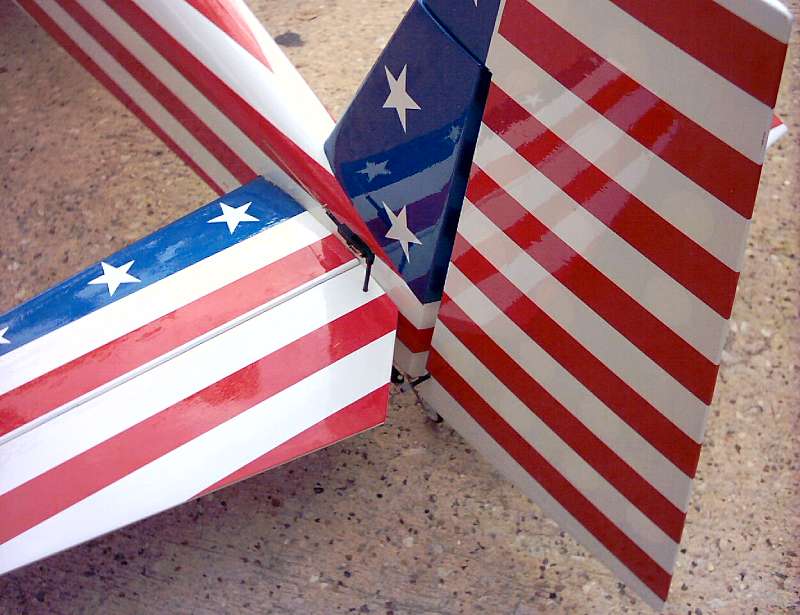

Old 08-12-2004 | 07:00 AM
flyintexan's Avatar
Joined: Apr 2003
Posts: 1,207
From: tomball, TX
With servo stuff out of the way, the fuse could finally be covered. Added some stripes (copy of Bert Sutton's Cap). The boys seem to approve of the color scheme so far....waiting to paint cowl and pants, then add some stars....

Old 08-12-2004 | 08:41 PM
flyintexan's Avatar
Joined: Apr 2003
Posts: 1,207
From: tomball, TX
Thanks Scoubidou....thanks for posting the original thread to give me some pointers.
Well, the trim was added and the cowl and wheel pants were painted to match.....the blue is a shade off...oh well.
Now, for the weigh in.......I am using a digital fish scale (up to 15lbs.) which has been accurate in the past....
Everything except fuel - 9lbs. 10oz. I will double check with another scale when I get the chance to take the plane to work. Right now, though, it feels very light.....lighter than my 11 lb. pattern plane.
This includes: YS140, tetra 16oz. tank, 1650mah Nimh, all servos, tru-turn spinner (lightened backplate), 16x10 apc, dave brown wheels, aluminum axles, mk tailwheel, spyder wire (fishing line) for pull/pull cables to elev. and rudder.
Ran the motor last night. Tint and glue on canopy and we're ready to go.....I hope.

Wow, 9lbs is very good! Where is your CG? Did you use a bellcrank for the elevator?
Old 08-13-2004 | 05:42 PM
flyintexan's Avatar
Joined: Apr 2003
Posts: 1,207
From: tomball, TX
Right now, the CG is just in front of the wing tube, but the batt. is also at the firewall. I plane to balance on the tube by moving the batt. further back. Do you fly yours with the CG right on the tube?
The elevators are setup with pull/pull cables to a single high torque coreless in the fuse.

Old 08-14-2004 | 03:56 PM
flyintexan's Avatar
Joined: Apr 2003
Posts: 1,207
From: tomball, TX
Here is a pic of the broken cable....looks like the sharp edge on the 4-40 threaded rod cut the spyder wire. The cable doesn't actually look like it is broken in the pic....but it is....at the end of the loop....frayed and cut.
