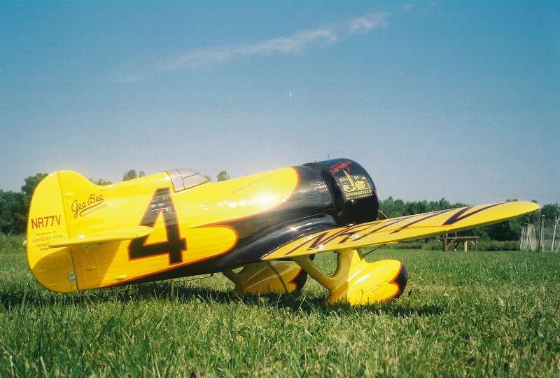

I have the KMP also and replaced the wire with new High strength wire... I was bending the wire it came with forward a little to get the wheels as far forward as possable and it broke... So made new set. I made an extra wire that went back to the wing at a 45% angle and solder in together with copper wire around it to secure it. I also did not attach the wheel pant to the wing with screws. I place thin foam under the pant where it touches the wing, mounted new hard rubber tires and filled the wheel pants with expandable foam... I'm going to see how this works before I invest in struts... I did see a pair of Robarts struts that seemed like they might work. I think they were 625 series just out this yr. Will check on and see #.
Pic a me and my friend with his Great Planes Gee Bee. By the way which flys great too.

I'm using a 120 OS pumped motor and my friend has a 150 saito wich balances perfect... Only problem I have is it needs tons of nose weight. Wish I would have went with the 150 rather have engine weight for balance then lead.
PS I wrote foam in wing in my other post ment wheel pants... I change it now. Remember when filling the wheel pants just add the foam slow an hold the edges of the pants to hold in place so they stay centered on the wheels. Remember the foam expands at least 1/4 - 1/2 of what you fill. I also taped the wheel pant tthe wing while doing this process...
Your motor should be fine.
Pic of my Kyosho Gee Bee
