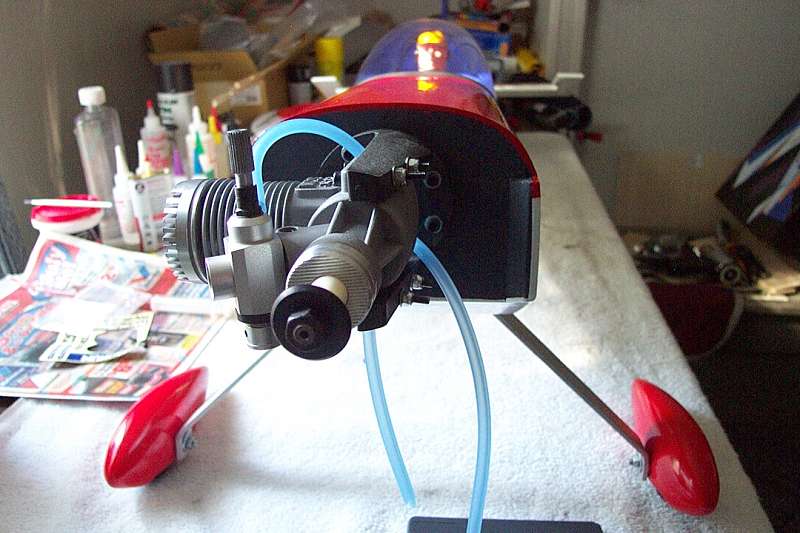

I have a Phoenix Giles 202 on the way from Tower and I am putting an MDS .58 engine in her,the muffler seems very large and it seems that the engine will be mounted at a 45 degree angle which will put the muffler out the bottom of the cowl in the center,does anyone have a 58 in theirs,Im just hoping this muffler will fit.[]
I probably could go with a pitts style muffler and turn the engine 45 degrees but I hope I will be able to avoid the extra money and work.
Thanks for reading!

Here is how I mounted my MDS .58..took the factory installed engine mount off, plugged the holes and redrilled for a Dave Brown
#60FS-6004 mount which fit perfect.
Insted of the 45 degree mount I have it @ 90 degrees as you can see, I will mount a Pitts muffler on.

P40 ... looks like you answered the whole thing by yourself! I have a friend who mounted the engine at 135deg ... the muffler was about to touch the bottom part of the firewall, he was unable to attach a deflector. A side winder installation is fine with a standard muffler. Pitts muffler is the way to go for this baby. She flies nice ... very nice.

I have the tank just braced up with foam rubber and I have the servo tray screwed down insted of glued because you can't get the tank out if you ever need to with the servo tray in.
As far as the pushrod for the throttle,just drilled the hole in the firewall and ran the rod back to the servo on the same side as the throttle arm on the engine.(use the thin wire and plastic tube they give you)
I also put the battery pack under the fuel tank.

The only reason I used the different engine mount was because of the larger engine.
If you are using a 46-52 size engine the original mount will probably work,I just couldn't get the crankcase of the MDS 58 to fit into the metal mount the kit came with.
I think most any mount will work,just make sure that the rails are as long as the original because if not you might have issues with
the cowl fitting,in other words if the rails are to short the engine is going to sit back to far and the cowl will not fit.
