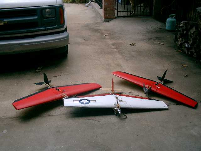

What about the wing? I've been flying combat for over ten years and it's the wings that take the most time to build. My planes cost about $20 (complete).

Nice planes... do u have the plans ??

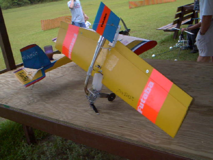

Here it is!The wing is made of coroplast and the fuse is 1\2X1\2 square aluminum tubing.This thing is very fast and virtually indestructable,and flies awesome.It is made by The Airplane Factory,designers of the Kombat 40 plane.Their web site is www.kombat40.com

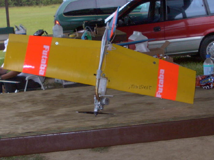

Here is another pic,these are pics of the Prototype,the newest version has the pipe underneath,and all the servos are concealed in the wing,it is very clean.If anyone is interested I will post pics of the newer version as soon as I get them.

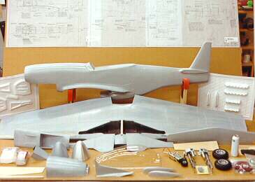

The molded fuse could come in 2 halves. This way you could create a slot or groove in the front for a firewall to be placed. So when the 2 pieces are snapped together to be glued the firewall would be held in place by the mold of the fuse. It would work like a clamp around the wall, you could put a bead of glue in the groove before the wall is held in place by the 2 halves.
Also, it would be much easier to install pushrods, and wires with the plane wide open, I have big hands so working in tight spots is a real pain.
Again, I want to stay away from the spads and such because They look like crap. Besides, a realistic looking combat plane like this would be great for sport flying as well.
A much larger more expensive example of what I have in mind are produced by http://www.aerotechmodels.com/P51.htm
These are made from carbon fiber and look sweet, picture this in 1/12th scale and made from cheap/lightweight/tough plastic.

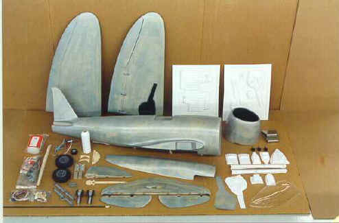

This could be done in small scale, no doubt!
http://www.aerotechmodels.com/P47.htm
