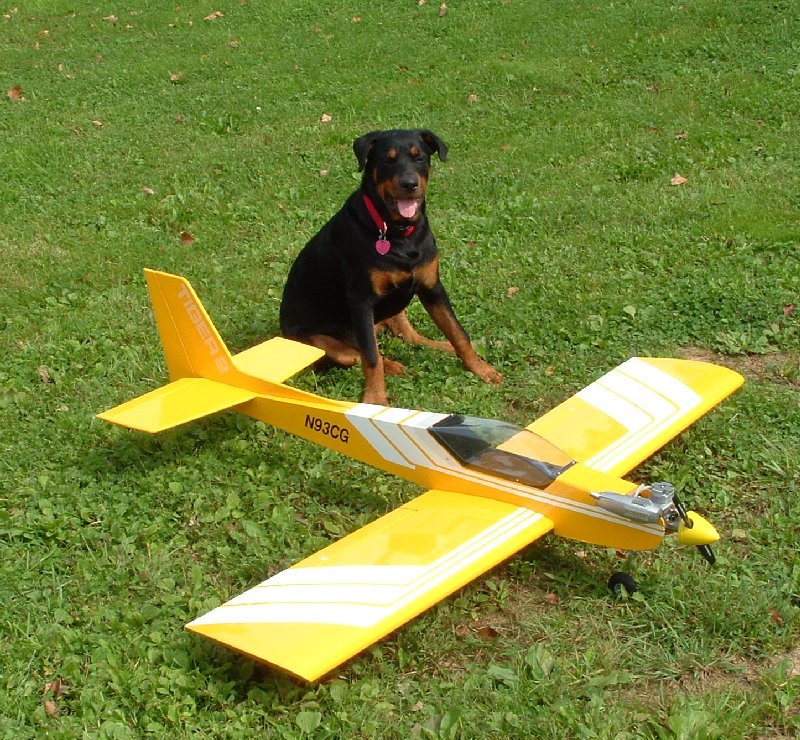

Okay, I've attached a pic. It sits okay now. BTW, the co-pilot's name there is Brutus. He don't fly too good but will tell you where the plane has landed. He aint chewed one yet!!! (my electric foamies of course)
Thanx to everyone for the suggestions!!! Yep, walkin thru cornfield aint no fun!!!!! Lotsa mud on shoes. The Tiger is gonna wind up a taildragger before too long. I already have a Twist and its a taildragger....
