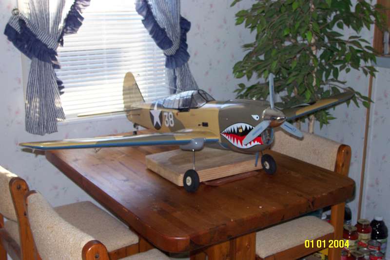

Old 09-17-2004 | 09:56 AM
P-40LUVR's Avatar
Posts: 649
From: WINDY, KS
Default RE: Props
NO WAY would I run a 2 bladed prop on my P-40'S..just doesn't look right..I just put big 4 strokes in little planes.[sm=lol.gif]
Old 09-17-2004 | 10:32 AM
Richard L.'s Avatar
My Feedback: (24)
Posts: 8,788
Received 4 Likes on 3 Posts
From: Renton, WA
Default RE: Props
Gray 3-bladed prop doesn't look right either Curtiss Electrics are black with yellow tips.
Old 09-17-2004 | 05:47 PM
P-40LUVR's Avatar
Posts: 649
From: WINDY, KS
Default RE: Props
The 1150 HP Allison engine stripped the black paint off the prop![sm=lol.gif]
