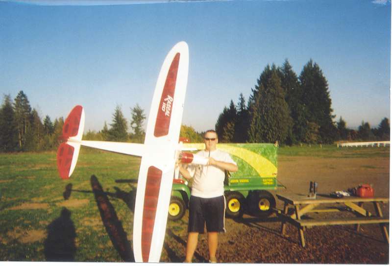

We have had some problems with trying to perfect it but, this pictures shows it in its complete form. We have outfited it with a Zenoah G-26 Gasser, Futaba Radio Equipment. It flys perfectly and we only had to drill 6 extra small 1/8 inch holes in the bottom of the cowl to make the cooling more efficient. The Gas tank had some problems but we made a small little airvent so that the tank was not going to colapse like it had already done to us.

Old 09-28-2004 | 07:26 PM
My Feedback: (13)
Posts: 2,177
From: Center of the Flyover States,
Default RE: My Sig 110
That wingspan is impressive. I was wondering how a larger engine say a Brisson 2.4 would work in this bird.......and a smoke system. I read a review that with a Saito 1.50 about two pounds of lead was needed to balance, so weight shouldn't be a problem. Did you have to add nose weight with the G26? Was it hard to fit the G26 in that narrow fuselage? What torqure Futabas did you use? How are snaps and spins? Thanks

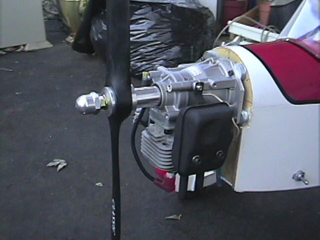

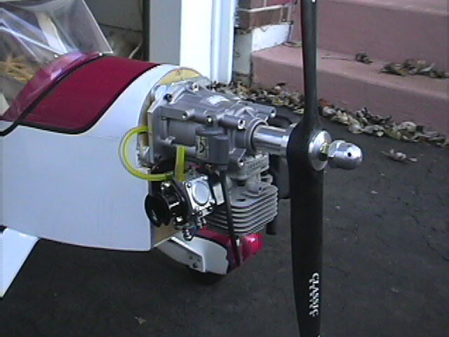

Old 10-23-2004 | 06:11 PM
IronicRcAv8r's Avatar
My Feedback: (21)
Joined: May 2002
Posts: 116
From: Fenton, MO
As far as not butchering the cowl it isn't possible putting a gasser on the narrow fuse of the Rascal 110 -- I just got mine mounted and have not cut the cowl -- waiting for my slimline pitts for it. But looksl like the right side will have a pretty descent size cutout for the carb assembly to stick out of -- and with the pitts looks like some small massaging will have to be done but the majority of the left side will stay intact.

Old 10-24-2004 | 10:21 AM
Volfy's Avatar
My Feedback: (23)
Posts: 3,227
From: Houston, TX
Nice install. Thanks for posting the pics. May be it's a personal taste kinda thing, but I don't mind the carb sticking out. I just don't like a few installs that I have seen with pretty much the whole muffler sticking of the cowl. Let us know how well he Pitts muffler works for you. If you can manage to keep from opening up the entire right cheek, I might just do the same setup.

Old 10-24-2004 | 09:24 PM
My Feedback: (21)
Joined: May 2002
Posts: 116
From: Fenton, MO
less than an hour -- I had one with a saito 180 on it and it took lees time to mount the gasser. The muffler is supposed to be in on Tuesday and I will get pics of it with the cowl on probably that night.
