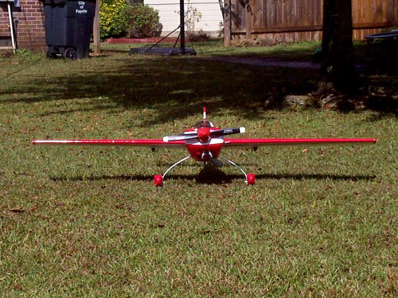

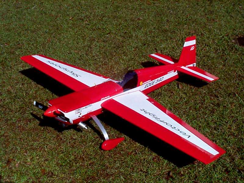

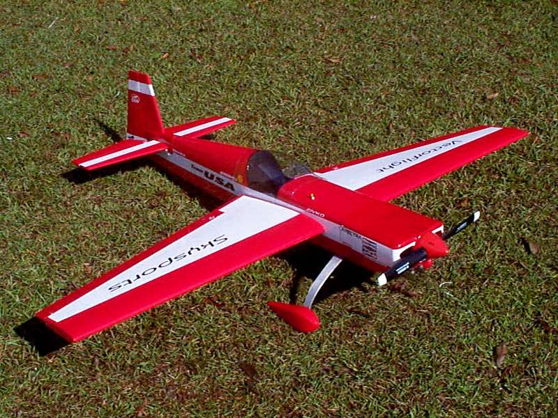

98% finished and squirming like a handcuffed kid in a toy store.[sm=spinnyeyes.gif] Being this close to flying such a beautiful work of art is cruel and unusual punishment.
I am amazed at how each little "problem" that has reared it's ugly head has been squashed by the utter simplicity of this masterfully built ARF. Even my own stupidity hasn't been able to foul up the works!
Anyone considering the Vectorflight line of models should stop considering immediately and go buy one! (or more!)

Premodus: Hey man youve been a great help and a good salesman (haha). Seeing that beautiful plane makes me want to build it now. But good things happen to people who wait.
In your pictures looks like it doesn't have a counter balance rudder. But i guess it was designed that way for a reason. But if I could bother you a little bit more. How big is the elevator / Rudder?
Cant wait to hear the flight report. Fill me in and others who read this thread for that matter. How beautiful the plane looks on the ground gotta look 2 times as better in the air. Cant speak for my avitar though...

Luke,
Looks awesome, I know the feeling! I just wanted to hang mine from the ceiling and admire it. But once I started flying, I havent given it a rest for over a year.
Suggest you put some dark stripes on the bottom of the wing. It spins fast and the stripes are a great help to know up from down! I also left the wheel pants off initially, until I mastered the landings and takeoffs.

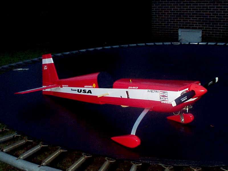

Installed the tail struts this morning on the top side only. (Should I put some on bottom also?) I used 2-56 metal pushrods, custom fitted and bolted thru both the horzontal and vertical stabs with 6-32/1" bolts. The tail needed the extra weight anyway to help move the CG in line. They are pretty stiff in both directions of flex so I opted not to add them to the bottom side at this time.

I agree with Crash Master. Bottom struts will lock the tail to the fuselage. Very important to do so! I used short struts going only about half out to all surfaces and they added tremendous strength without putting on any serious weight. Definately an area where a stich in time saves many later![8D]
