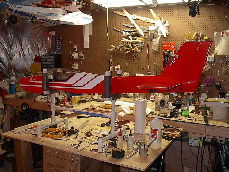

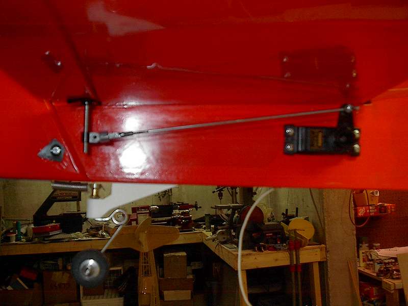

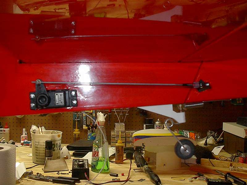

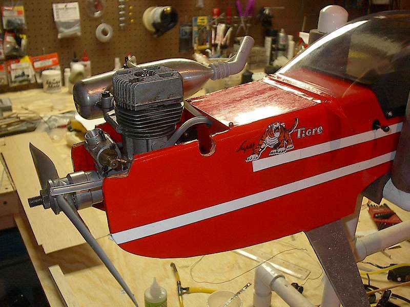

Here you go. Balances 1" behind the rear cg mark. Flies like a dream with all the verticle you could want.[8D]

Thanks for the pics. Nice installation. I noticed you went for the tail dragger option. I will be doing the same, never flown a tri-gear.
