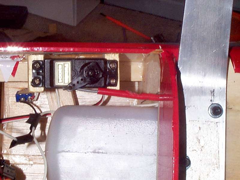

Gary,
Here's a couple of shots of how I set up my throttle servo. Using two balsa blocks screwed to the side of the fuse. This is the best I could think of based on the instructions interpretation.

Primodus,
How is your tank held in place? Is it suppose to sit out that much from the former? Did you get all your plumbing figured out for your fuel tank? After doing more research I think that I may switch over to fuel dots. I read on here that the fueling valves, such as Dubro's and Great Planes', may develop an air leak over time and cause your enigine to run inconsistently. It makes a lot of sense.

Actually, the fuel tank does go in a bit further, remaining only 1" to 1-1/2" out past the former. I have finished the fuel plumbing, though I have still have to reseat the tank and put in a balsa crossmember to hold it in place. There is plenty of room for foam insulation as well. The 3 line setup tested well, and shuld make a cowled fueling much easier with the fuel dot placed in the fuse side behind the firewall.
