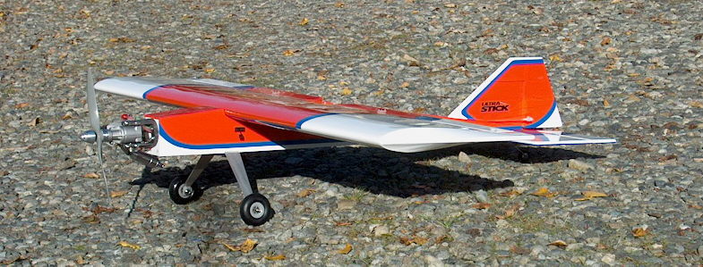

Just maidened my Ultra Stick this weekend. Oh Man!! I love this plane!! I put an O.S. 70 in it and worked out all the weight/CG issues. It flies like a dream. Lots of power. I have a 13 X6 prop on it and not sure if this is the size that will work best on it. I had started out with a 12 X 8 but wanted to slow it down some. A 14" seems like it would be too tall and hit the grass. Any suggestions?

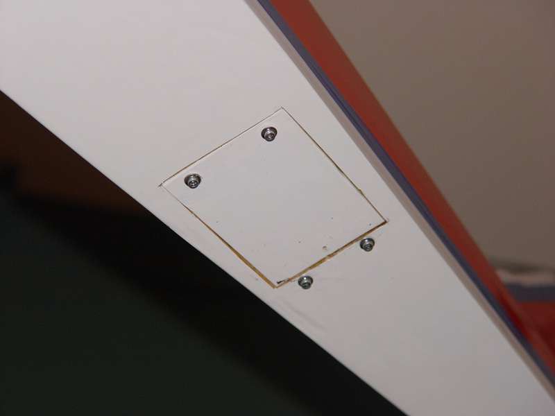

I made a hatch in my tail and put the battery back there. Perfect balance. I also added the glass filled Dave Brown engine mount. The Harry Higley 0.8 alum ounce prop nut spinner will take an ounce off the nose as well. All sorts of ways to move the CG back.

Hey Joe, for the hatch you made for the battery, is that on the underside of the tail? Any pictures of it that you could post?

I have pic's of the final installed hatch but not the uncovered one. You can see the tie wraps buldging out through the Ultracoat. Just cut a square hole big enough for the battery (and a little frame around the hole). Frame around the hole with balsa. Put 4 holes in the hatch for tie wraps then treat it with thin CA to harden the hatch. Glue a little piece of foam to the inside hatch. Put the battery inside, fish the tie wraps around the battery and pull them tight. The battery will wedge itself agains the inside framing and pull the hatch tight. Then cover it with Ultra coat. I would solder the battery extension instead of using a connector. I used a connector but I would solder it if I did it again.

CeeGee, here's the hatch I made. The battery attaches to a raised platform on the other side, and the whole assembly is easily and quickly removeable.

Thanks Steve. That looks clean and simple. I might move the servos back there. Not sure at this point which way I'll end up modifying it. Here's a couple of pictures of my U. Stick with an O.S. 70

I saw CeeGee's plane fly yesterday with the OS 70. It is very light and powerful, a real performer! Good looking too with the new red color scheme!
