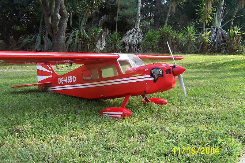

That is the stock covering right out of the box. I didn't even clean it.
The shine must be the reflection of my beautiful coworker who's holding it.
Actually, it's from the combination of a bright sunny day, and the fact that she's sitting in the shade of a large tree. What you're seeing is the reflection of the sky coming through the trees

Your coworker certainly adds to the glow, no doubt about it... I'm going to have to move back to Minn.. Seems you have access to an endless supply of these "coworkers" :-]. The plane in that picture on this screen looks like it has a gloss on it a mile deep... Strange effect....
