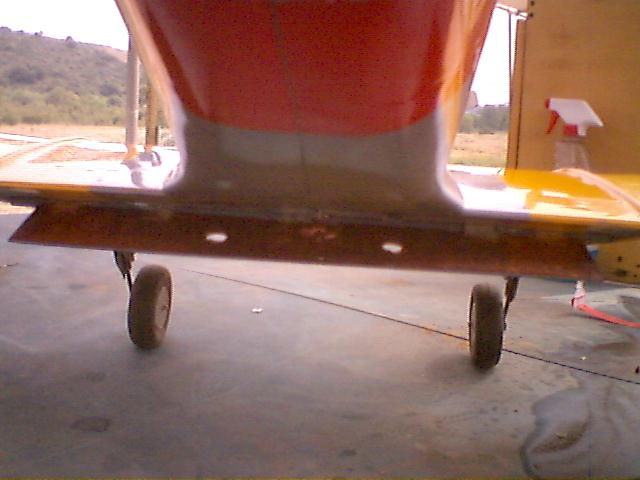

hello i have the kyosho texan and it flyes great but landings and take off are some what hair raising so i took it opon myself to add flaps to it and now this plane comes in so slow and under control,i tryed to make it tip stall with the main flap down and the only thing that the plane did was to loose alltitude,no wing tipping and no nose dive,just a gradual decent,i also changed the muffler so it comes out the side and forgot to re tune the engine,and sure enough the plane whent dead stick on me,i just lowered the flap and regaind control and landed on runway
