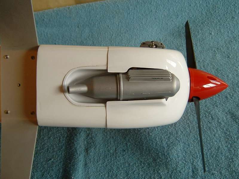

I mounted the muffler and cleared out the bottom of the cowl to fit. The cowl is now screwed in place too. You can clearly see the concave bubble that get installed if you choose to mount the engine this way. The muffler fits perfectly in this pocket. Overall I like the look. It's not quite as nice as a proper in-cowl muffler, but it doesn't stick out like normal, and the rest of the engine is nicely covered. Just the head popping out. I'd still prefer an inverted completely cowled engine, with an inverted pitts muffler, but nobody makes a good invereted pitts for these small engines.
Oh well. Here's the progress today:

There is an oil cooler cowl bubble that pretty much got removed to clear the muffler. Too bad.
Anyway, still a great sport scale kit. I will eventually paint the struts and landing gear legs white.
You can see it covers the muffler completely without any holes. The instruction say to open up the left cooling hole so that the muffler gets a blast of air, but I don't see the point. It's got enough room around it to draw air. For the needle valve, I put a small socket head screw into the end of the needle screw, and drilled a small hole in the cowl. So all you do is stick an allen wrench into the holes to reach the head of the screw. Seems to work well so far.
I also mounted the windshield and skylight. Interestingly, it appears they left out the skylight instructions in the manual! No hardware I could find either. I just used some small screws I had lying around.

Looking good! What size prop do you have on there and how much clearance is there for a tail up, main gear landing? I'm trying to figure out if I'll have problems with a 13 incher.

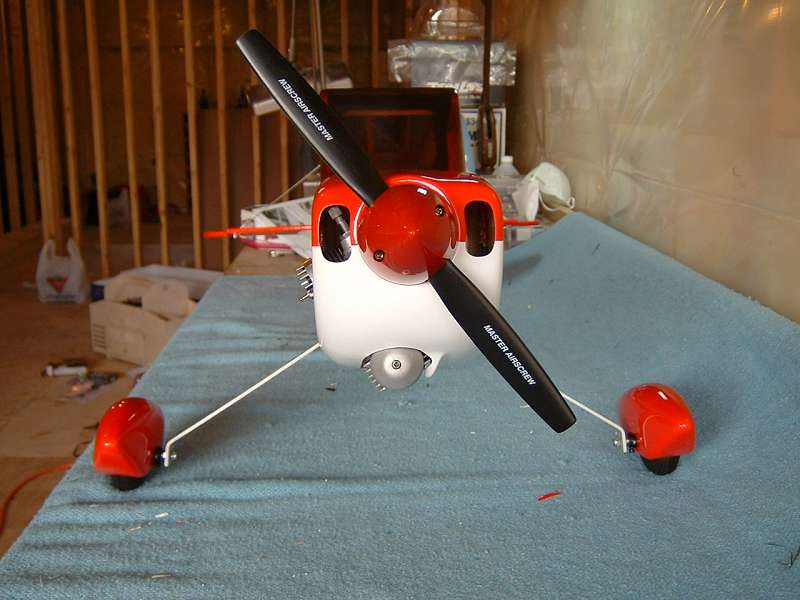

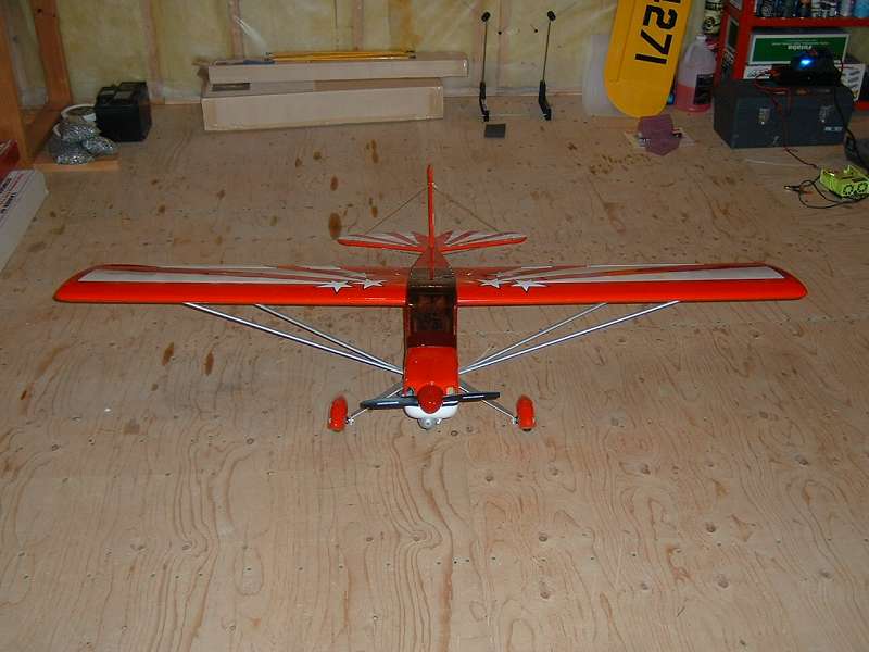

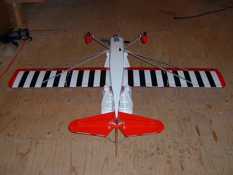

Ok, the plane is basically finished now. I put the stripes on the bottom, got my 9C, aileron differential set up, etc... just waiting for good weather.[
So, here are the pics, probably the last ones before I get it out to fly. It really is a great looking airplane, I'm very happy.
]So, here are the pics, probably the last ones before I get it out to fly. It really is a great looking airplane, I'm very happy.

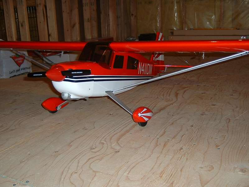

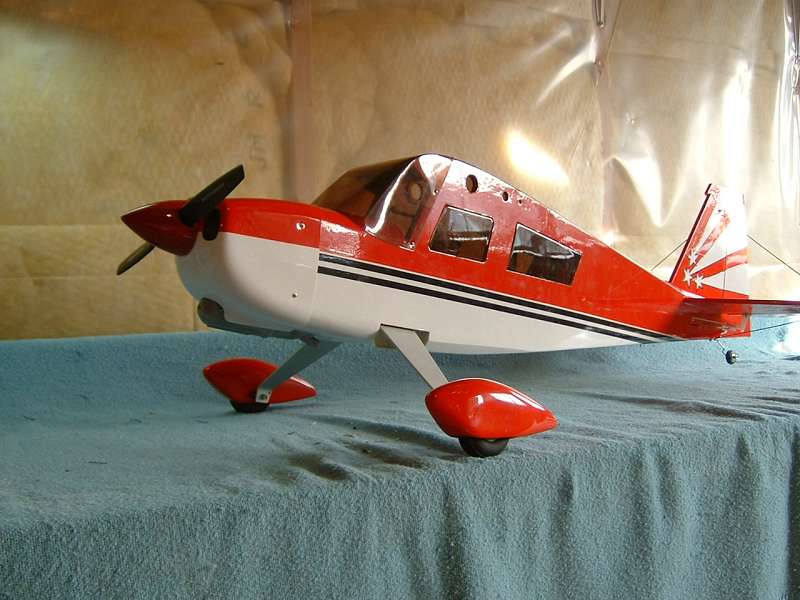

And... more pics
I think it's much much better looking than the Seagull model, and practically on par with the CG or Dynaflite. Obviously not perfect, but pretty darn scale for a cheap sport 40 sized plane. Hopefully it flies as good as it looks!

Looks fantastic! Great job on the build..... I hope the weather gives you a break soon up there...I know you hope so too
Good looking wheel pants too! Did you do the starburst scheme or did they supply a decal for that? They look great!

Yup, the starburst is included as a decal. The pants are very nice fiberglass parts. I used Dubro wheel pant mounts instead of using the plywood/screw method.
As you can see, I'm using a Dubro refueling valve, and a switch with charge jack on the bottom. I like putting them on the bottom so they aren't visible, I don't know why most people seem to put them on the side. Am I missing something?
If I can find a high temp white paint, I might paint the muffler. I'll likely paint the struts and landing gear white eventually.
Also, the plane looks a lot like one flown by Andy Koontz in airshows. He has a few large sponsor decals down on the white part under the canopy. I might use that as justification
for putting a few down there. It's a little plain looking. Just the included Thunder Tiger Decal, maybe Futaba, whatever.
I'm not quite sure what to do with the antenna. I don't want to run it up to the top of the rudder. If I run it through the fuse, it will still hang out about a foot past the rear, and drag on the rudder in flight, which probably isn't cool.
