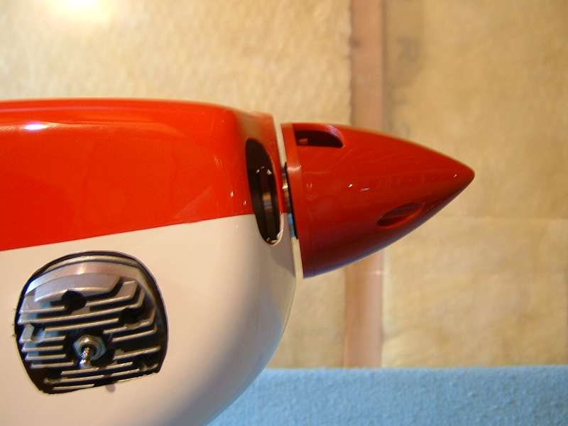

The new version is set up for the engine to be mounted diagonally down, putting the muffler dead center on the bottom of the cowl. The head will poke out a little bit too. They have included a neat little plastic molded piece, where you can cut out the the bottom of the fuse to clear the muffler, and glue in this plastic piece to close up the hole nicely. They seem to have engineered the whole thing around the TT .46Pro engine, with predrilled holes, etc. for the mounting.

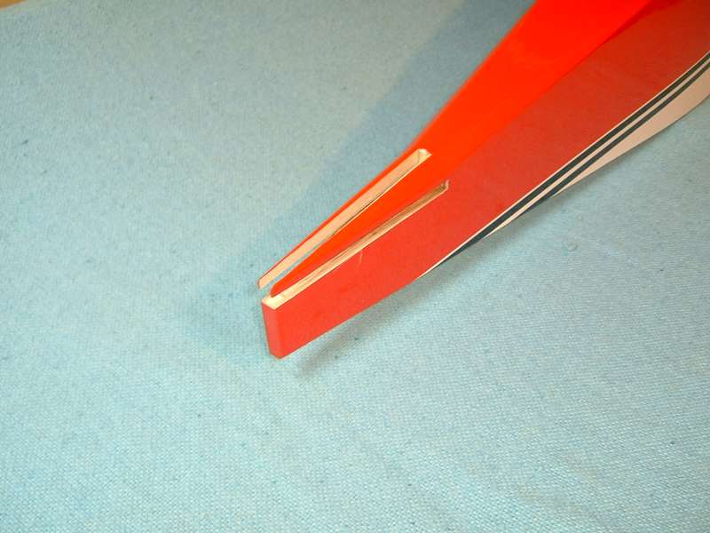

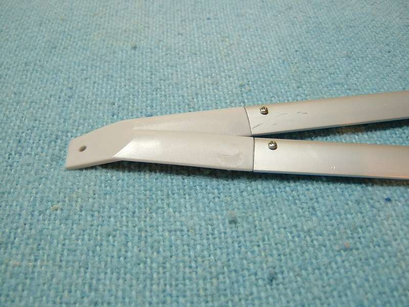

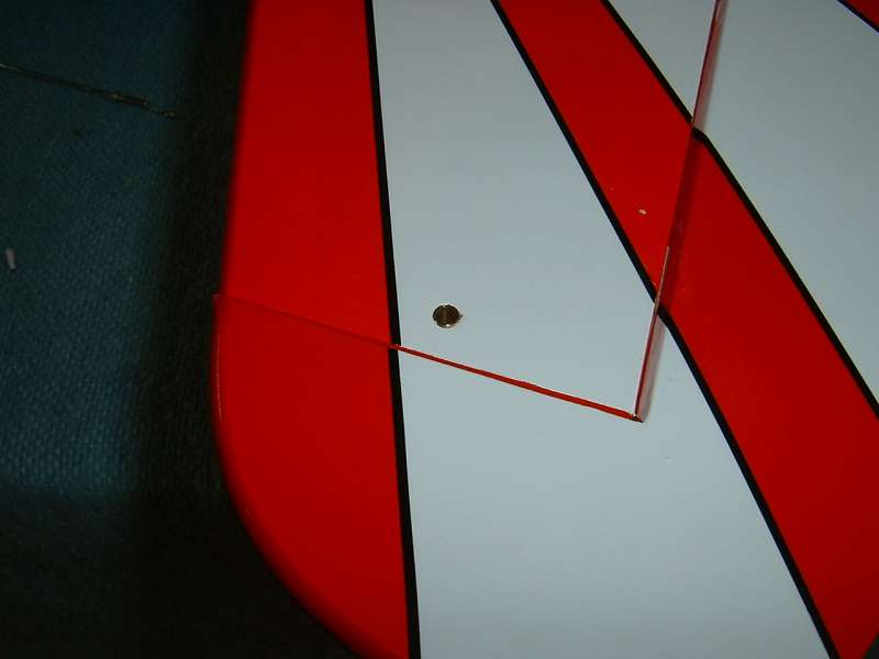

Ok, here's some pics I took last night. I'm even more amazed than earlier. The fit of the parts, the way the whole thing is designed is incredible. I'd have to guess it was designed on 3D modeling software, laser cut, and all assembled on a jib. For example, the wing tube is just slightly firm to push into the fuse holes, and I didn't have to touch anything. That's as-is laser cut holes. Same thing in the wings. Tube is a slight slip fit. The tube ends inside butt up right against the end of the tubes in the wings. The side windows just pop right in, it'll be a snap to glue them in.
The only thing I had trouble with was cutting away the covering over the "spacers" that they put in where the tailfins go. It was a little tricky to find them.
Oh, and the manual is written in Engrish. The language isn't great, and the instructions are a little vague, but great pictures and professional looking otherwise. Not good for a 1st ARF kit, but definitely for your 2nd or 3rd you shouldn't have a problem. It's not much of an issue, I'm barely even paying attention to it, because everything just kinda fall into place.

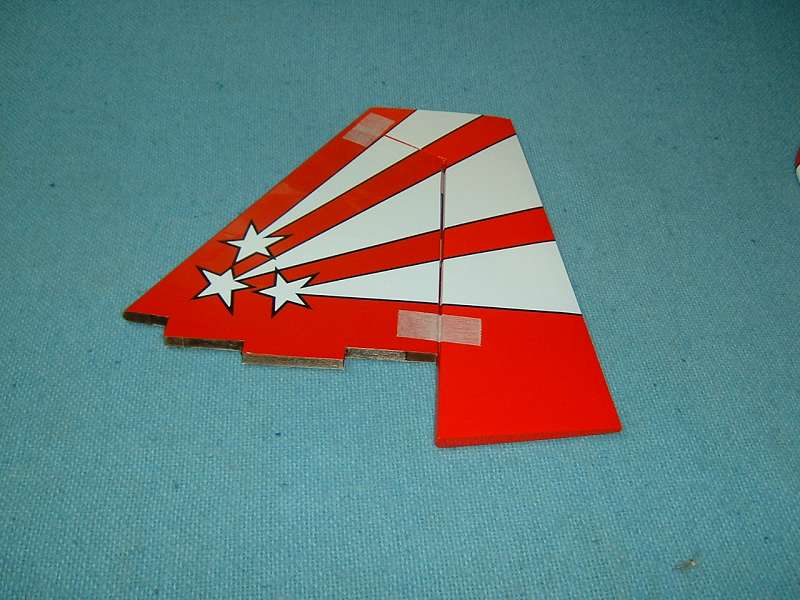

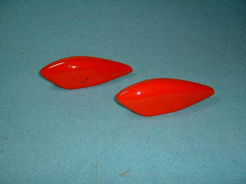

More Pics
I don't know what the mottling is in the photo of the tail fins, it's just a digital image artefact. The finish is flawless.

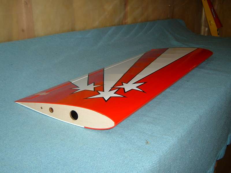

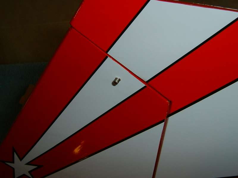

Yup, the wing appears to be fully symetrical. I would also say the struts are required... though maybe not structural (load bearing).
There is a large fiberglass tube, about 16" long that slides into the fuse, then the wings slide onto the tube. The only thing holding the wings onto the tube, is a screw on each wing. There's a predrilled hole in the wing, and you just have to finish drill into the tube. Run the screw, one per wing, that's it holding them onto the tube. So, the wings get a lot of strength from the tube, but the only thing holding them ONTO the tube, is one screw. The struts probably aren't needed to take the load, but they have a second job, which is to form a rigid triangle, which helps hold the wings from sliding off the tube.
I don't have any experience with two piece wings. Maybe this single screw retention is normal. But I won't fly without the struts, cause I think they help hold the wing on.
I mounted the fins last night. Both the vertical and horizontal go on at the same time, since the vertical plugs THROUGH the horizontal. They appear to have come out totally square with eachother and the fuse, without much effort.
And that's about all the gluing required for the kit! The wings are two piece, and the firewall is already fuel-proofed! It's just bolt on from here.

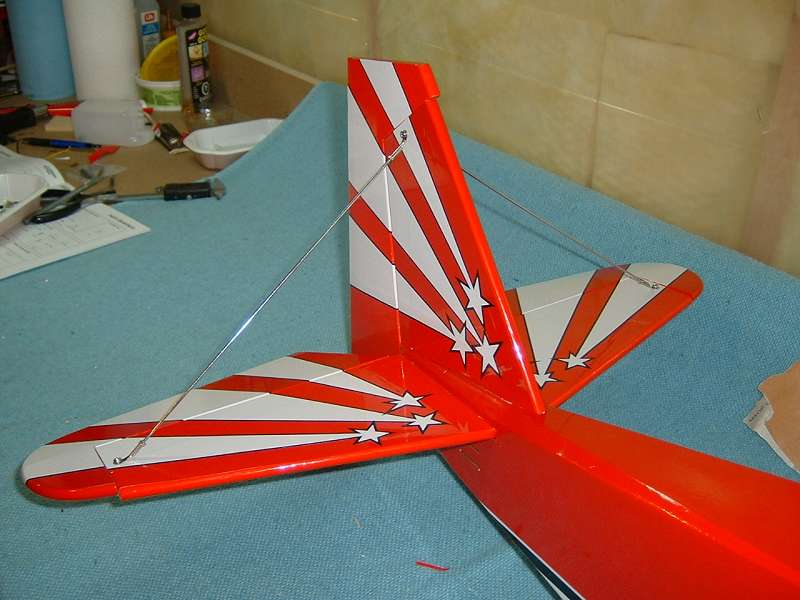

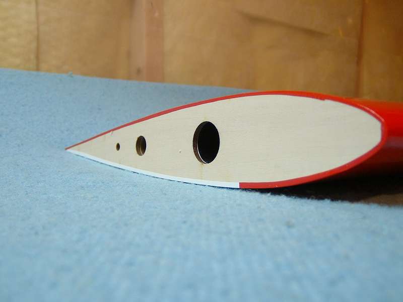

Alright, had less build time this weekend than I would have liked. I figure I'm about half done.

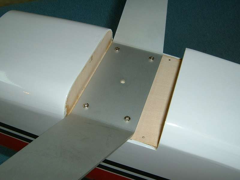

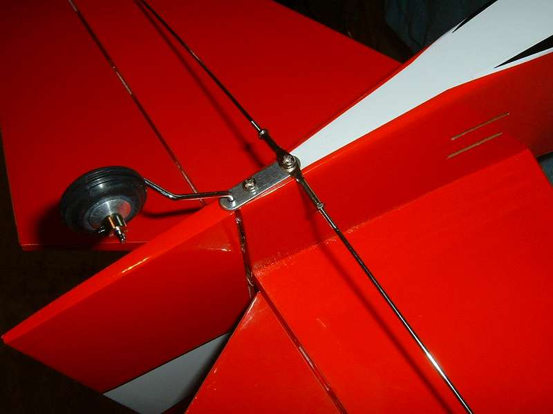

Here is the mounting method for the tail braces. I think it's pretty slick, though I don't know if it's common or not. There is a 4mm hole drilled in the surface, and you insert a short brass tube. This way you can really tighten the screws, and the tube takes the compression load. Also gives more bearing area for the loads on the wires.
Second pic is the vert.stab. with the screw protruding waiting for the clevis on the other side.
The third picture is the center mounting point. The braces screw into the metal tailwheel strap. You can also see the included jam nuts on the wires. Oh, and you can also see the wires are chromed.

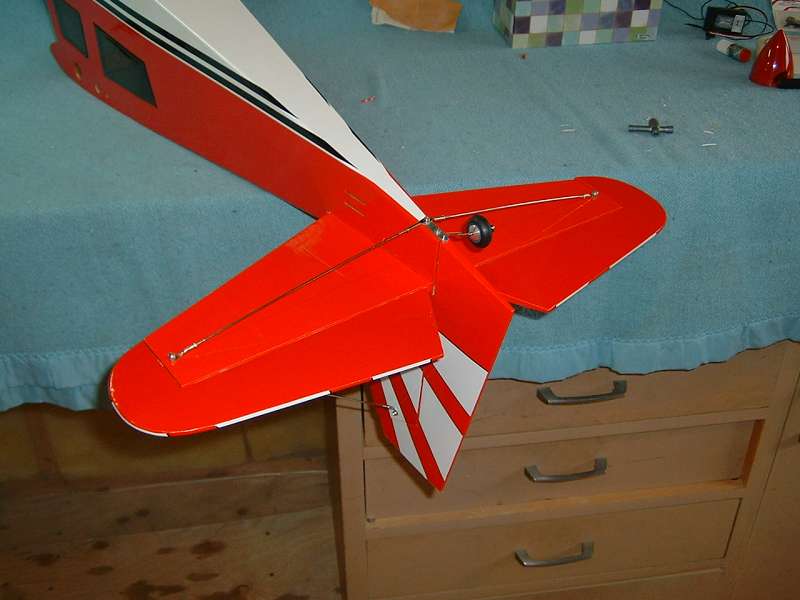

Last pic is the overall underside of the tail.

First pic here is the topside of the tail with wires.

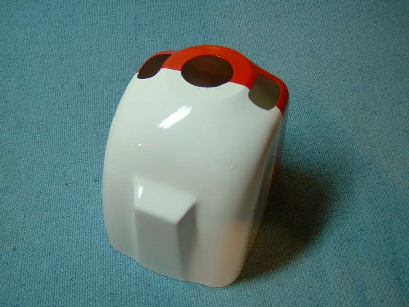

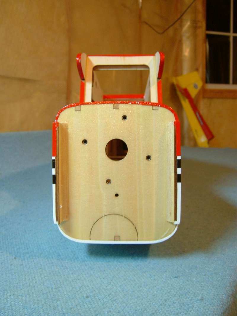

I'm pretty darn sure that I'm going to use my TT 46 Pro. I've got this thing lying around, and the whole plane was litterally designed around it. I'll be VERY surpised if it needs any ballast.
I have thought that a nice Saito 82 would be nice mounted inverted... I love the Saito in my Cub. I doubt I'll ever buy another 2 stroke (this 46Pro was bought years ago and never used).
But then I'll still have this engine lying around... So, I think I'll use it.
I'll probably mount it up and check the balance. If it needs a stupid amount of nose weight, I'll go for the Saito. Otherwise, I'll put the 46 pro in.
When I say "designed around it", I mean the holes predrilled in the firewall position the engine diagonally, so the muffler comes dead center down the middle of the fuse. They partially cut (dotted line with the laser) the wood in the area around the muffler so you clear it out, and glue in this plastic concave bubble to clear the muffler. It's a really slick setup, and really hides the muffler.
This makes the engine head stick out of the cowl a bit, so it's not as scale as I'd like, but it's a lot better than 99% of the other 46 size sport-scale planes.
If you mounted the engine straight down, it would be completely enclosed, but you'd need to do something with the muffler. I didn't see any inverted Pitts style mufflers I liked. I'm leary of the strap on ones.
I thought of getting a fuse mounted tail wheel, but I didn't want to deviate from stock too much. I'll give it a shot. I haven't had a problem with this setup before, but don't have much experience. What should I look out for?

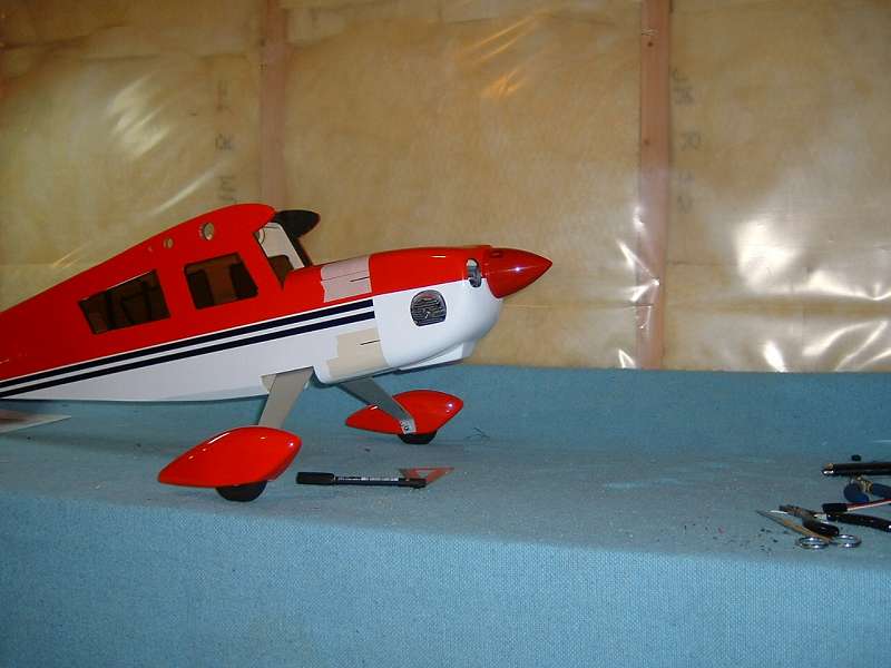

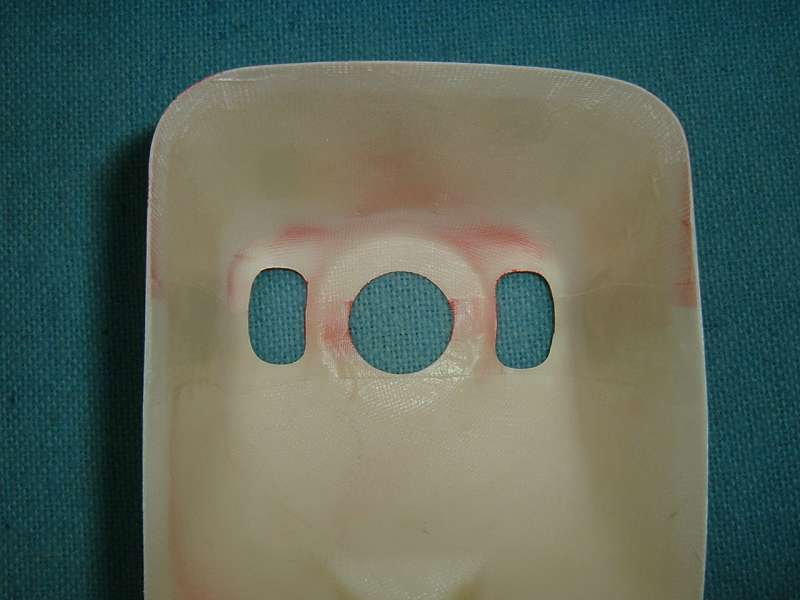

Ok, last night I did a rough balance check. I have all the servos in and hooked up, except for the throttle servo control rod. I dropped the reciever and standard battery in the fuse right under the CG, where the pilot would sit. Mounted up the wings with all hardware minus the struts (which are basically right on CG).

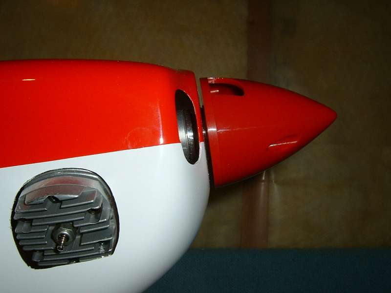

Installed the engine and muffler, MAS prop and spinner, and sat the cowling on the engine as best I could. Also put the empty tank in place.
I think the only thing missing is the throttle pushrod, struts and... oh the cover under the landing gear (which is very light and under the CG). And the electrical switch.
Balance was basically bang on. Just a *touch* nose heavy I think. I bet with the battery mounted under the servo tray (lots of room) it will come out perfect. No lead needed at all.
I'm not surprised really, since everything else is designed for this engine (17.1oz w/muffler BTW), and the tail is built pretty light. The fuse has lighteing holes cut in the tail area, and the stabilizers are build up, not solid.

Last night when I hooked up the elevator, I found I didn't like the pushrods. I find the wire they use it too soft and bends easily. I'll probably replace it with a fiberglass ones. Stiffer and lighter.

Ok, tonight I went ahead and started mounting the cowl, with the TT46Pro engine in the "factory" location. Again, this will place the muffler dead center under the cowl/fuse, with half of it exposed.
I did my best job ever so far. Just cleared out enough for the engine head to peek out. Right now I'm debating... do I get the front of the cowl to line up perfectly with the spinner backplate (two planes parallel? Or do I move the cowl to have a streamlined blend onto the top of the cowl? The two are mutually exclusive. Just a small error in the cowl I guess.
I looked at some pics I had of full size SD's to see if the cowl lines up with the spinner or not (streamlined blend into the cowl top). They're all over the place. Some yes, some no. It appears some use aftermarket spinners or something, that are smaller, so there is a step going over the cowl.
I took some pics of what it looks like if I line up the cowl parallel to the backplate. It's probably what I'm going to do.
It may all sound really silly... it's just an ARF... but I enjoy scale planes.
Oh, and BTW, that is the spinner that came with the kit. It's high quality, and I do plan to use it. Nice piece. I might eventually get an aluminum spinner, just to make it more scale. But for now it'll do. I also used the factory horns and clevises. Good quality parts. I did replace the included CA hinges with SIG CA hinges, as the factory ones were a little smallish.

The Global S-D used a tiny-ish 1-3/4" spinner. What size does this one take??
The cowl looks very good! You're way better at cutting than I am....

I didn't measure it, but I think it's about 2.5" or something. A fair sized spinner. I noticed on many of the full scale planes, they have tiny spinners.
Thanks, I try hard on the cowls. I find they can make or break a plane. I've certainly messed up my fair share. I just really take my time because I think it's a very important step.
I've learned to use overhead projector transparencies to help make a nice clean cutout. And a dremel of course. In this case, I mounted the engine with the drive washer being 105mm from the firewall, as specified in the instruction. Then I removed it, and mounted the cowl, and measured 103mm to the firewall. That roughly sets the "depth" of the cowl on the fuse. I put tape around the fuse with one edge flush with the edge of the cowl, and remove the cowl. Then, cut out a square of transparency, and tape it to the fuse so that the rear edge is butting up against the tape I laid down earlier. Now it's at the same depth as the cowl. Then I marked the red/white transision on the fuse covering, on the transparency, to get my vertical spacing.
Now mount the engine, mark the transparency, cut it out, check the fit around the head. Remove the transparency, and tape it to the cowl so the rear edges line up, and the red/white transision line matches the cowl. Then go ahead and cut it out. This was my best attempt yet.
See the tape I have laid on the fuse in the photos? With the black line? The black lines are exactly 5cm long, with the front end being exactly where I want my hole in the fuse. Now when I reinstall the cowl, I can measure forward 5cm from the back of the line, and hit my target fuse mounting point dead on. Stops from guessing where I should drill the cowl to hit the fuse point.

Our methods for cowl cutting are similar. I use card stock reather than clear. I am going to try your method of transferring the template to the cowl. That sounds easier. I've been leaving the template on the plane and sliding the cowl in place to mark the cut outs. Your way sounds like I wouldn't need a third hand!
I'm glad the spinner is a little larger than scale, I absolutely hate grinding out spinners to fit the prop.
