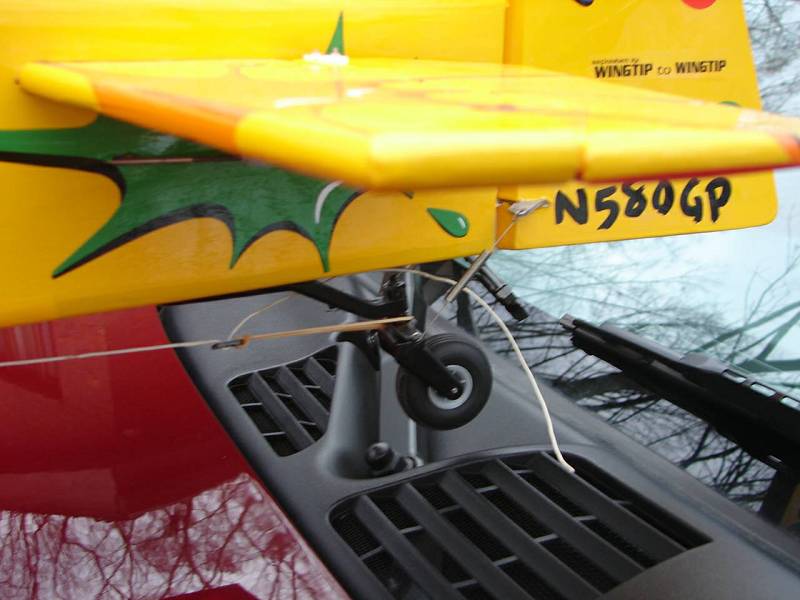

Here's some pics of mine. I only have a AX-46 with a Bisson Pitts in it with a 11x5, but for now it will do. Although I would like to step up to a 60, it flies very well; it does everything but hover. [8D]
