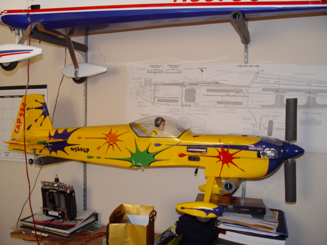

I had all but given up on this bird, but thanks to new and fresh tips I have a renewed interest to try this pig out. Weather is horrible here though. It's currently -10F with a west wind blowing 10mph. This puts the windchill at -29F[:'(]
[&o]. Feels like spring will never come, but I'll have the splat ball bird ready for even a mild day.
Thanks for all the new tips and advice. There might be hope yet.
Anyone here from Steve Campbell lately?
[&o]. Feels like spring will never come, but I'll have the splat ball bird ready for even a mild day.Thanks for all the new tips and advice. There might be hope yet.

My little CAP is hanging on the wall, ready to fly. It hasn't been out in many months; what little modelling activity I've done lately has centered around fine-tuning my gasser. But my "splat ball bird" (love that one!
) has earned a permanent place in the "hangar".
The gassers are so much less hassle than glow birds, though. My next "project" is a GP Patty. I finally got the BME 50 singing, and after 18 months on the H9 Extra I'm ready for another airframe.
But the little CAP is a great "beater" plane. I certainly hope you get yours sorted out. I cannot imagine (past what I already suggested) what is causing yours to snap. Like Bubba said, recheck your elevator throws. And reflexing the ailerons may do the trick.
