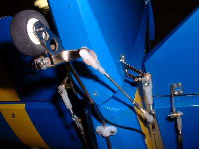

About 14 flights now, things are going well, until I tried to taxi in the wind today...the stock tailwheel w/springs is pretty weak as far as steering goes...so...I came up with a 2-56 ball link/rod/nylon clevis setup. Will try it tomorrow...photo shows it...
