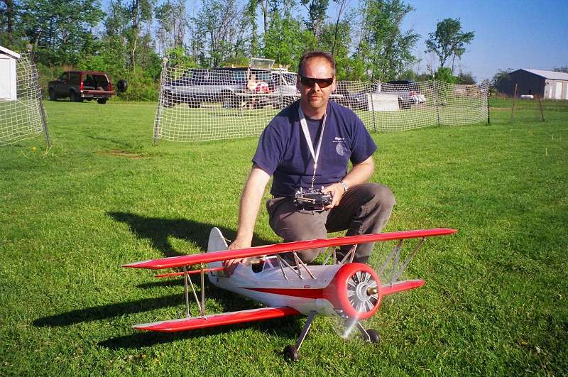

I put the fuel filler dot right in the middle of the red stripe of the cowl on the right side of the plane if your facing it. While I was breaking in the motor I just used a zip stripe and tied the fuel line to the motor mount. The remote igniter I just epoxied a small block of wood the the fire wall bottom left side and mounted it to it. "I didn't have the plug in type". I have a saito 100 in mine too and it was great. I used a big Groupner 4 stroke paddle which made the motor sound great and so much pull it was unreal, could fly on next to no throttle use very little fuel and fly forever. thought about switching to wood, but my saito ran so well on the groupner I decided to leave it alone. I had too big a prop so would only get 8700 RPMs. Was always going to switch it but flew and ran so well I decided to it alone.
A note on mounting the Cowl... The saito vibrates the hell out of the cowl and where the screws mount it will crack. So if you make the holes for the screws the size so the fuel tube just fits through, then cut a small O ring to fit in it, then slide the screw through it and tighten it. The fuel tube will expand and make a perfect buffer for the screw and it won't crack the cowl.
Everyone who I ever talked to always had to do some down trim after take off so expect to do it.
Couple picks of my plane and 1 on my other fav planes DR-1 just because I like it!!!
Good luck and let me know how it goes.

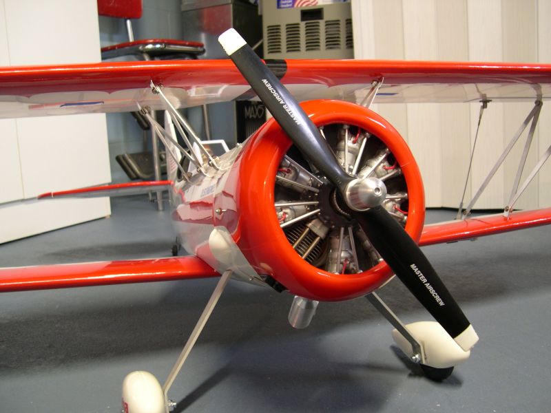

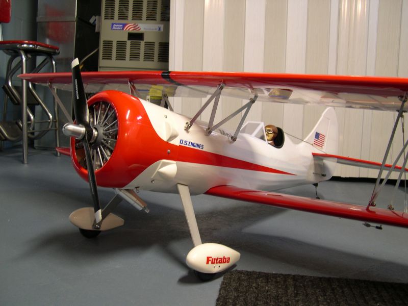

Bruce, i thought I'd jump in here. I've had a Waco .60 for a year now and it's really a nice flying biplane!! Mine has an OS 91fs in it and has plenty of power. I'm turning an APC 15/6 prop. It may be just a bit much for a 91fs but it flys real nice with that prop. Your Saito 100 should handle that size prop real well. Larger prop looks better with the big cowl. I mounted the engine at a 45 degree from vertical to get the muffler out the bottom.
I also got new bolts,washers and locking nuts for the wing struts from Ace hardware. I leave the wings on all the time so I don't have to assemble it at the field. Just put in the back of the truck to get it there.
Good luck and hope you enjoy the Waco!

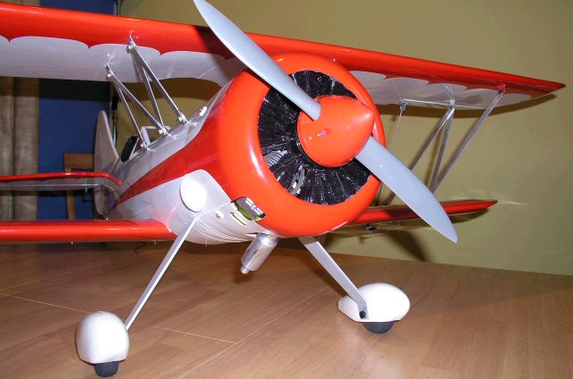

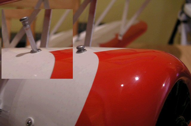

I haven't put a lot of detail into the plane, just made some practical choices. Personally I've found the standard aileron throws give a very crisp roll rate without having to modify them, but to each his own. Here's a few pics, hope you find something useful.
1. I really like the look of the spinner but really I'm just lazy and don't like hand starting, especially hot engines
2. Fuel filler - I could have hidden it down the side but it kind of reminds me of a radiator cap where it is
3. I just used electrical tape to hold the gear block in
4. I also replaced the strut nuts with nyloc nuts and hex sockethead bolts

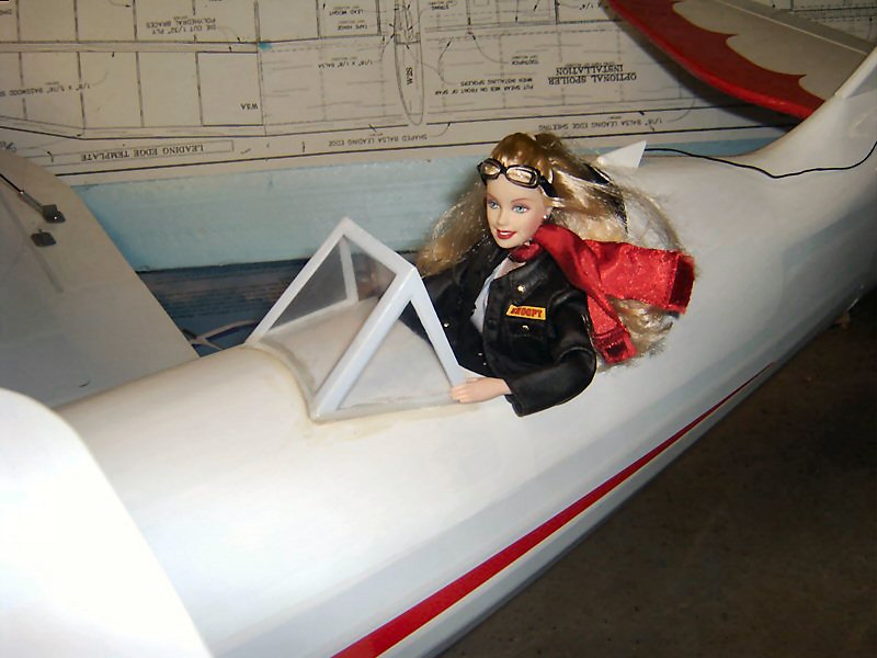

Actually it was Barbie that took out my plane. I just epoxied her to the Balsa inside the cockpit. After time with the wind hitting her she tore loose the Balsa she was epoxied to and hit the rear stab / elivator and riped it right off the plane... Needless to say it didnt fly well with only half the stab & elivator...
Though I already ordered a new Barbie and new plane will be ready by spring....
