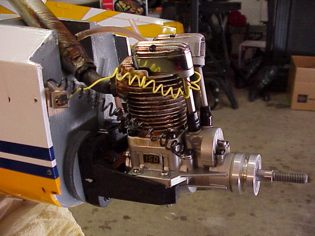

Default Decath with a Saito 150
Well, I am about to make myself subject to some expected OVERKILL statements but,
I happen to have a Saito 150 and I am going to stick it in the Decath.
I will let you know how it performs.

Default Decathlon with Saito 150
Well, I took her out for her maiden flight yesterday.
All I can say is that this is one of the best flying Decathlons I have ever flown. What a sweet bird.
Tracks so wonderfully.
Absolutley no rudder input on take off. With the 150 up front it literally yanked her into the sky with authority. Very little trim needed for hands free flight.
Loops and rolls are on good straight lines with the obvious rudder input. The ailerons need a lot of throw to have this plane snappy.
Landing was a breeze.Naural nose down attitude on approach with the slightest of flare to plonk her on the mains.
I think I am going to really enjoy this plane on any day.
I am glad I have the 150 in it. Verticle is as you can imagine. In fact I wouldn't want anything less in it now that I have flown it this way.
Negative: Wing struts are crap in design and want to keep coming off. Need Sullivan clevises with the retainer clips all round.

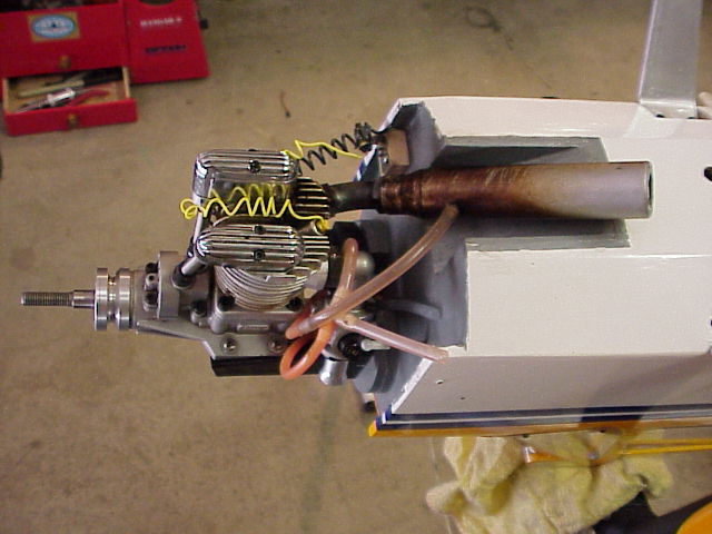

Hey TheEdge,
Did you have any trouble with the cg balancing with the 150? I might repower mine from an FA-100 to something larger in the future.. Also, is your 150 horizontal or inverted? Any pics?
Brent
ps: Birddog, I'll let you know when my CF gear/tube shows up and let you know what I think of them, along with the weights..
Old 05-07-2002 | 05:12 PM
  #45
Banned
My Feedback: (788)
Posts: 1,101
Received 16 Likes on 9 Posts
From: Bonita, CA
Default In response
Yes the motor is inverted with a remote glow attachment.
The CG is spot on, only because I had to place my Battery pack way back in the fuse. I cut out and added an access panel for it.
Well worth doing in my opinion

Default Picture
Hope this works

Default Another view
Zap

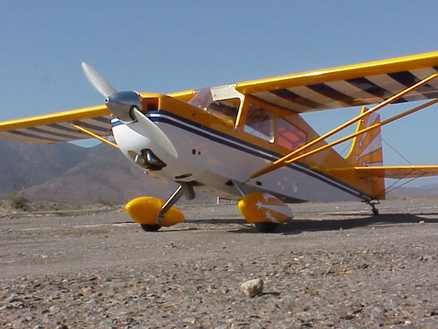

Default One more
Zoom, zoom, zoom, zoooooom

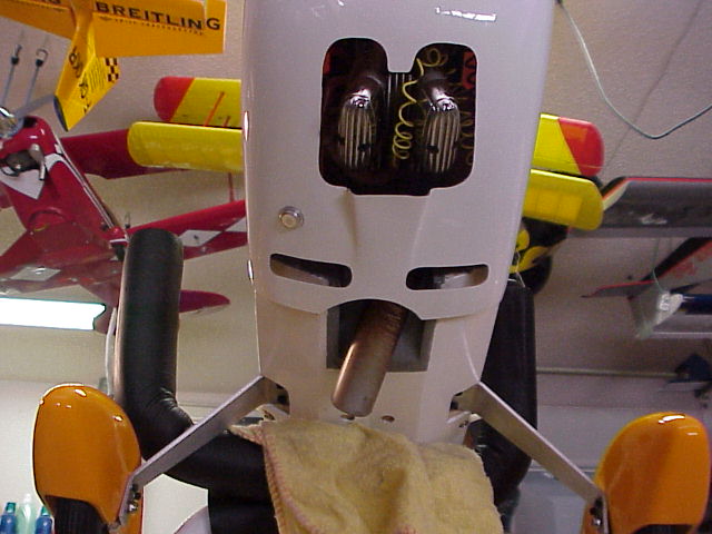

Default And another
Ready
