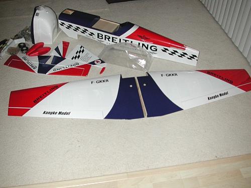

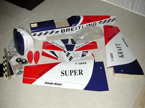

Just arrived at my doorstep today!
The wing panels and tail feathers are built-up and very light. The construction, covering job, paint work, and quality of wood are excellent! The hinges are already installed and ready for CA. The blind nuts for the landing gear are installed, as well. There are strings through the wings to make the servo cabling easy. The decals have already been applied!
A few complaints, though... the wheel pants are of the rubber ducky variety (no problem I'll use the 1.20 size Cap pants I just got from Hangar-9 by accident), the tail group does not use an airfoil, and the control surfaces are not double beveled (I'll make a 1/16" gap and seal the hinges for more throw). Assembly looks painless, however. Should have it done by the end of next week. You can follow the progress on my website.
Not too shabby... I don't care for the pre-applied graphics on the wing though. How does the quality of the cowl look, and how well does the paint match? Also, what did this guy cost?

Hi Plane Insane!
>>How does the quality of the cowl look, and how well does the paint match?<<
The quality looks excellent, nice and light, too. The color is a perfect match.
>>Also, what did this guy cost?<<
$303.99
>>I don't care for the pre-applied graphics on the wing though.<<
If we're thinking the same thing?... gone, done.
$303.99

Hi Plane Insane! (may I call you just plain Plane?<g>)
>>Will you be updating your website through the construction phase... I'd be interested in seeing how well it goes, and what you run across.<<
I'll keep the website updated, yes. Already I've noticed that there is a built-in option for dual elevator servos in the tail (as well as the included push rod).
I also noticed that I was wrong about the lack of double beveling on all surfaces. The elevators, in fact, are double beveled and capable of 80 degree throws.
I was wrong about being able to use a 1/16" gap to get enough throw on the rudder and ailerons, as well. There's just no way that's going to be enough. I'll have to double bevel those surfaces. Looks easy enough, though.

If possible -can you take a moment and give me the weights -as best you can - for...
Cowl: 7.2 oz
Wing half: 15.3 oz
Wing joiner: 1.8 oz
Rudder: 1.4 oz
Vertical stab: .7 oz
Horizontal stab with elevators attached: 5.3 oz
Wheel pant: 1.4 oz
Replacement H9 fiberglass wheel pant: 1.1 oz
I figured the wing area at around 1000 squares the day I got the model... I'll get an accurate number to you soon.
