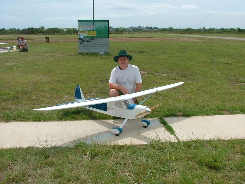

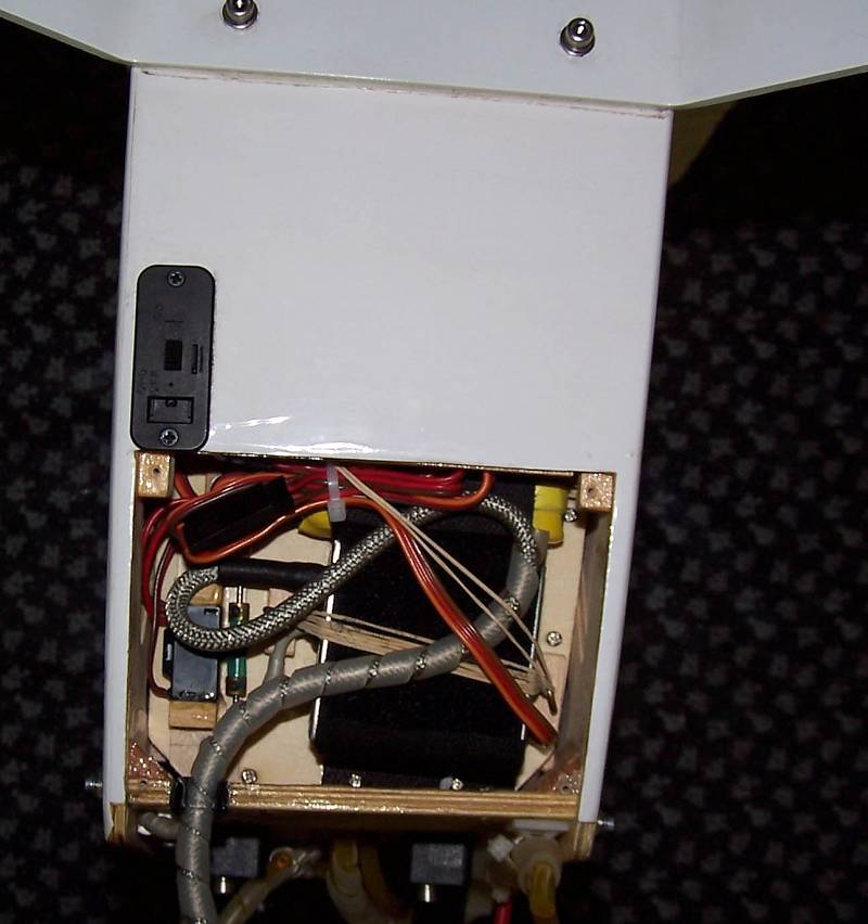

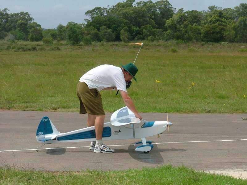

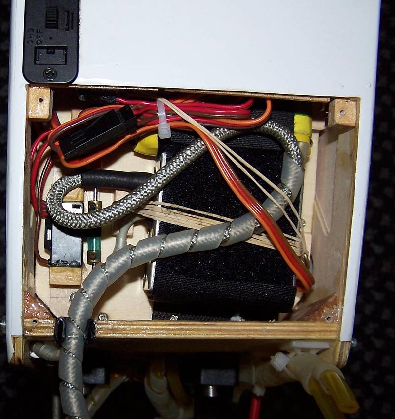

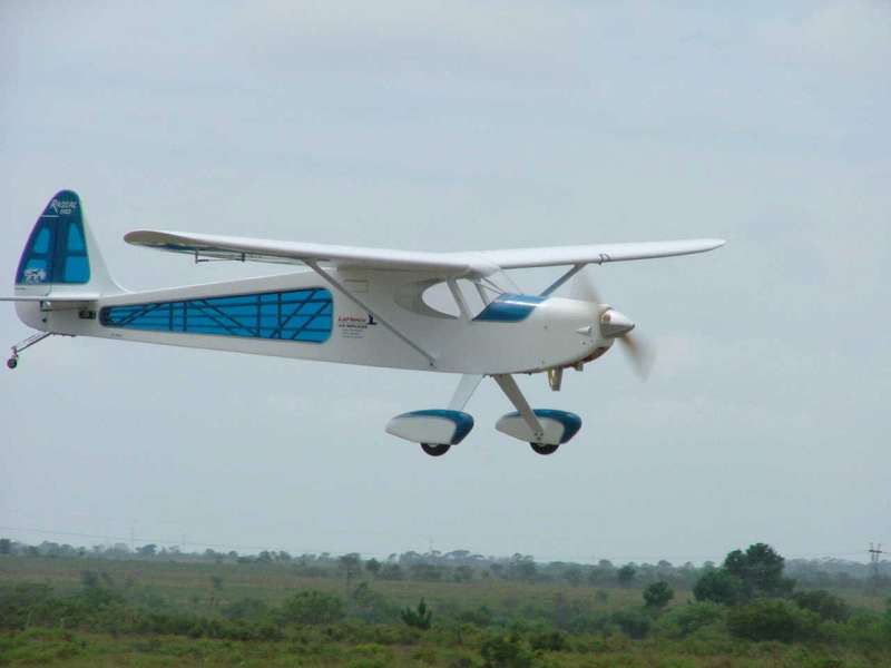

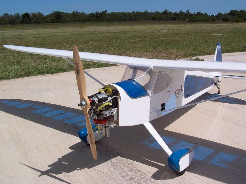

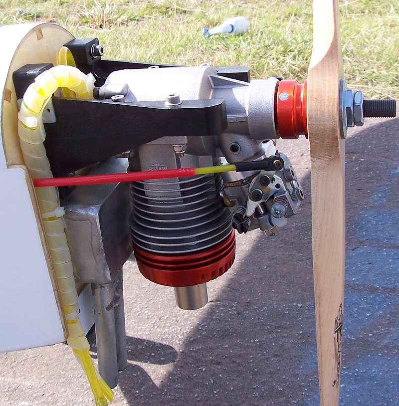

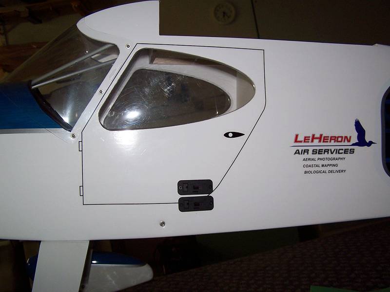

Hi

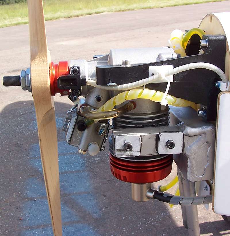

Motor fits easily but you need to make your own muffler.
My muffler sounds cool with a popping sound.
Pulls it nicely - motor is new and have not yet maxxed it out.
Vibration is not a problem at all.
Maiden flight on Saterday and it flies great - this plane can slow down so much you wont believe it - this is with dual 1100mAH packs for the rx
and a 1100mAH for the ignition [X(] (I think it can fly slower than my light Magic Extra )
I can turn this plane so flat with rudder and opposite aileron that it it looks like it is on rails.

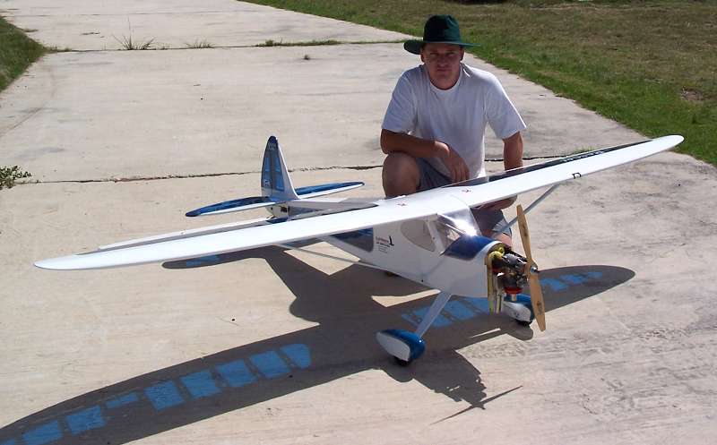

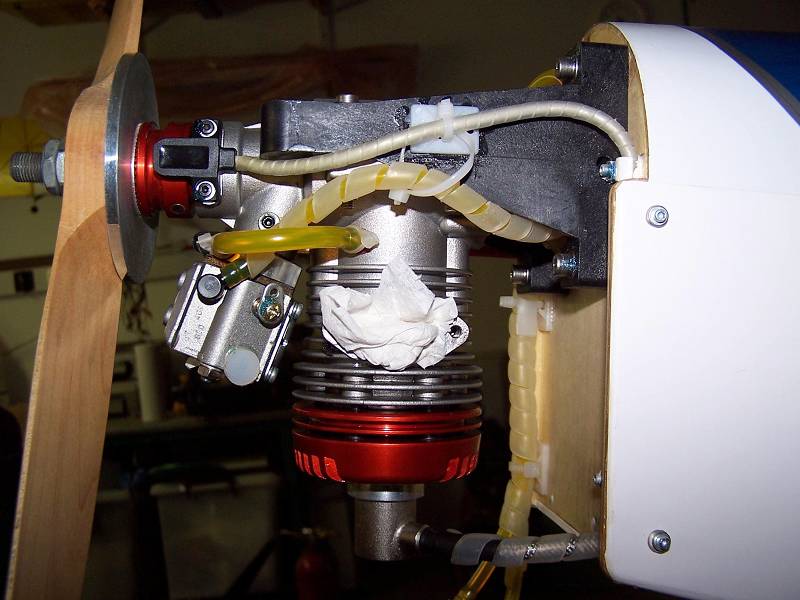

Completed !!!

Thanks for the photos!
I have one of the 110 in the box, and it is nice to see a setup without the sides of the cowl cut.
Old 02-22-2005 | 09:08 AM
Posts: 6,571
Received 5 Likes on 5 Posts
From: Arcen, , NETHERLANDS

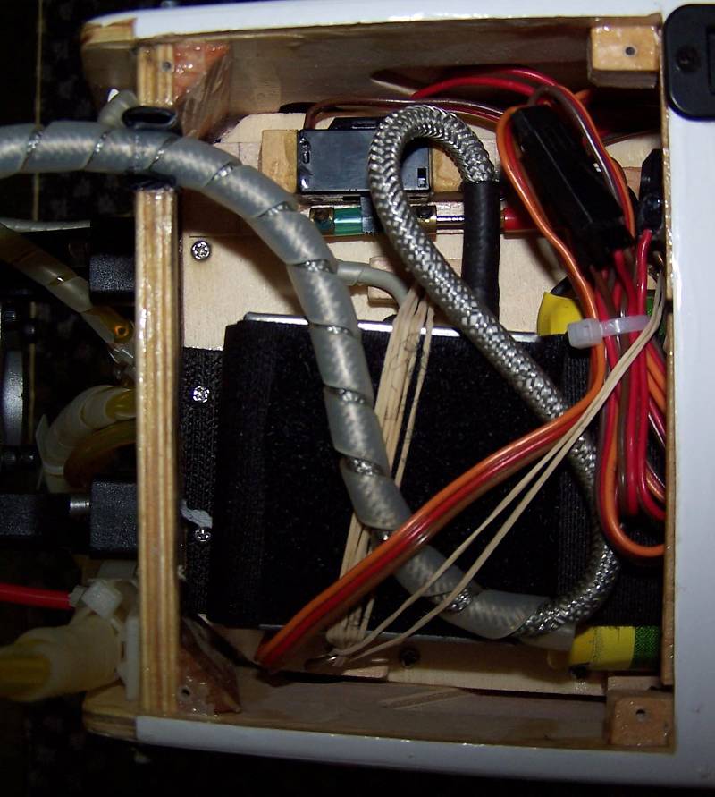

Default RE: Rascal 110 with MVVS 1.60 gasser pics
A wonderful plane with that elliptical wing.
I see you made all the little things work, like extended throttle arm, protected wiring and gas line.
Any intention of using this plane as a workhorse?

Hi
No - but I found that this game favours the pragmatic approach !! Besides its such a nice motor (and plane) that it would be shame not to do it properly.

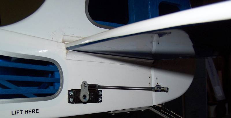

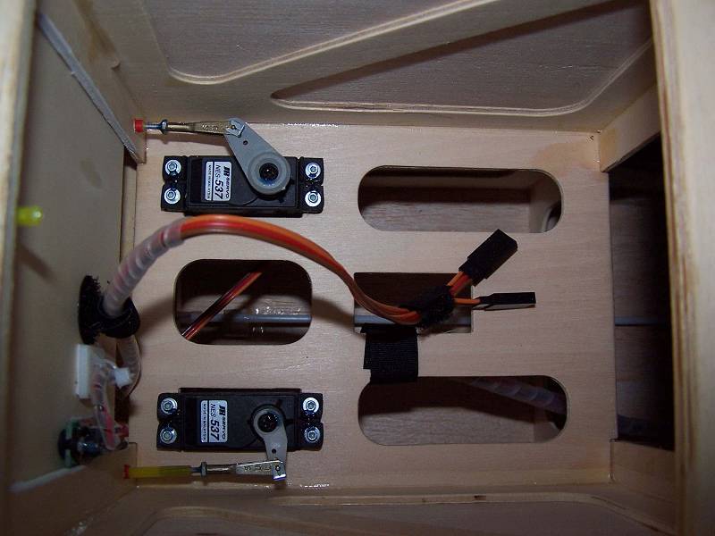

Forgot to mention that I think that this is "the" gas motor for the Rascal (if not the best alround choice).
With the slightly heaver motor and ignition battery I could place the rudder servo in the tail in the already provided cutout thus eliminating the pull pull. Even with the 3 batteries onboard the plane is
an absolute floater.
Another factor is that the MVVS is a bit cheaper (here in SA at least) than the four stroke equivelant for the Rascal - (no 2 stroke glows in this baby [:@]), that coupled with the
low price of gas compared to glow for this size , Oh did I mention the totally reliable idle and throttle up and much less cleaning up and easy easy start and and ...
Seriously though I think this is the best set up.

Great job on the plane. Looking forward to receiving my MVVS 1.6.

Looks like you cut, and re-welded the muffler?
She sure is a beauty!

The weight without fuel is about 13.5 lbs but the plane has 3 1100 mAh Nicads - this is really not a problem, it is still light in the air !
I am using a 18x6 and stayed with the stock fuel tank (just put in a gas bung) The stock Sig spinner internals were to small for the 18x6 and I replaced it with a Protech Aluminium
one.
This is the 4th 110 Rascal at the club so I made one or two very minor mods - I will take pics and post them.
a65l: You should see how flat this baby turns !!
Kmot: Had to make the mufflere as I could find nothing even close - actually had to make 2 - found out you cant really weld on the muffler once its been used - seemingly due to the oil.
