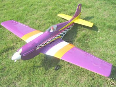

I have been following the Dago Red for a few years. This is a 60 size with a 65inch wing. Was the Dago ever in this color scheme many years ago-like more than 8 . Or is this a new color setup Looks like it say #3 on the back end , If so its an oldie?

I think I found it after doing a bit of "Yahoo." Its the "Voodoo" but they had it listed as a Dago.

That's a VooDoo, or something.
Looks to be the same airframe EZ marketed years ago in the true Dago Red colors. Basically, it was their P-51 with a different top deck/canopy.
A GREAT-flying model hindered by crap retracts. It was my first (and last) retract-equipped model. But it would be a crime to fly something like this with fixed gear, yes?
I have been wondering if the new EZ kits are the same exemplary quality we saw before the factory burned down.
I know the price is at the same levels of extortion... but you got your money's worth, IMO, back then.

Its the VooDoo and perhaps an EZ one? VooDoo was Dago Red's main competitor at Reno.

Thats not made by EZ,Do a search on ebay and you'll see. If you go look up the EZ Voodoo its much nicer looking.

If that's the one on epay, then it's a knock off...I believe there have been several versions of this plane with different color schemes. A friend has the all yellow one. There is also a silver one with red trim...There are also 2 different sizes...

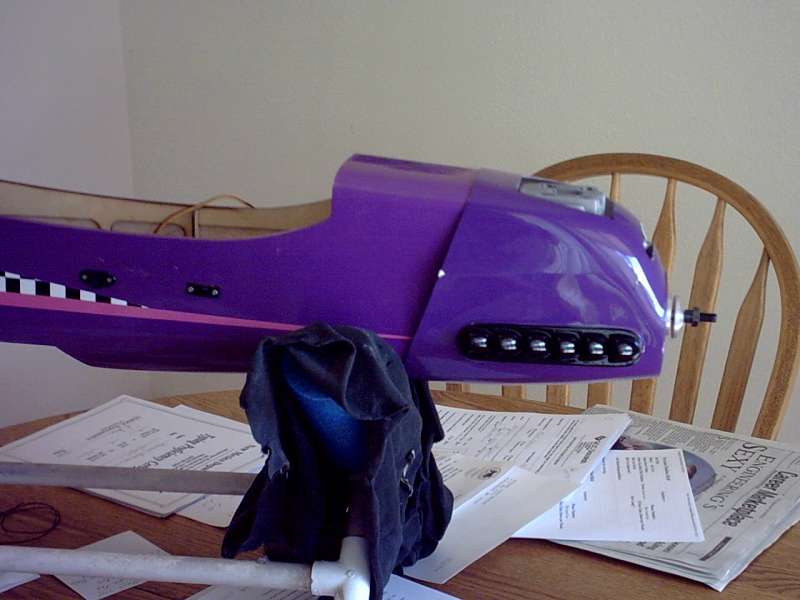

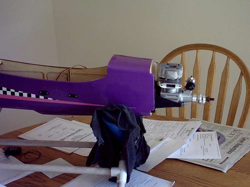

Heres a couple shots. I was originally wanting to install another Jett 90. Couldn't find a used one at a decent price. So I got a pad and wrote down many numbers from different engines. Many thing a G2300 is a hughe engine like the 3250 but its not. It is no bigger than most 120 fourstrokes and the weight is about the same or a bit less.
So at $150 for a NIB 2300 and $85 for a Jett Stream muffler, I came out pretty sweet. I beefed up the front end and retract area. I just rebuilt the fuel tank area. Since the engine is inverted , I am installing the Graupner 500cc (17oz)square tank. I gutted out the old mounting area and rebuilt so now it is about 1 inch lower than stock.
