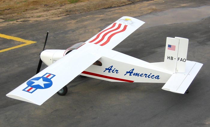

Pilatus Porter Finished !
This is the one that was reviewed in MODEL AVIATIONS Sept issue. I'm powering it with an O.S. BGX, and it flys like a dream.
Thanks R/C Plane Power, you got a winner here.
The Porter is one of my favorite planes. I loved all the STOL stuff in Air America.
Glad to hear it is a nice ARF - did it build well? Any surprises?

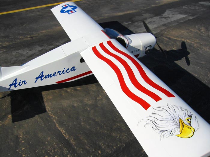

No surprises, it was just a very enjoyable build. This ARF just screws together. The only glue that I used was some epoxy to fuelproof the firewall. All control surfaces are already installed, and the whole ship is covered with Oracover for a real nice finish.
It flies real light and slows down beautifully. STOL at it's very best.
Another view >

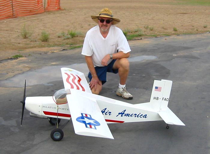

Originally posted by Taildragger
Jim, Whats with the shorter nose on yours? Bill
For some history and nice Pics, try this link >
http://mypage.bluewin.ch/aviationworld/pc6/
