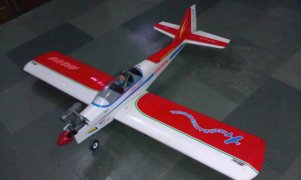

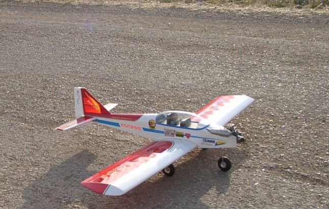

OK so today I opened the box and started to work.
I apologize for not having a digi cam but will try and describe the process in the next week or so of assembly work.
First thing done was not in the instructions at all - I checked the covering all around. Quite a few edges were starting to lift away so I ironed them back with an iron with the triming shoe. No problem but the covering Polycote ECS seems very "cheap". It already looks a bit "used" and the color decorations although embedded within, are not at all fantastic in quality.
I also started fuel proofing the tank and engine area, and doping inside the fuselage where the RC will go (I do this to all my models).
Construction is very average, not rubbish but neither outstanding. It is certainly very light and the materials are in my opinion a little too soft in most areas. Already dented in a few areas, it came out of the box this way.
However, all this suggests it will probably end up a very light model, and with proper caring after it may be a good flier for quite some time, I hope.
The original wheels are already in the bin...the metal wheel and small rubber tier are neither light nor good. I substituted with slightly large dia. Graupner light wheels I had in hand (used a little). The axles are long enough to accommodate this, as if VMAR knew this would be done...
Oh, and there was a small crack in the back of the firewall - easy to fix but why was it there in the first place?

The fun goes on. Although the model is progressing nice and quick, quality is not there.
There were 6 wheel retainers in the kit. All of them had the thread stripped immediately the moment I tried to tighten them a bit. All had to be replaced.
The manual shows a white tape for covering the wing centre joint. In the kit it is a simple transparent tape. Why not white? still it works ok, the wing joint line is clean anyway.
It does however look a rather "cute" model with nice colours.
The manual is not very good. Some steps not mentioned at all e.g. the front dowel in the wing l.e. - there is one dowel provided and one hole, the manual show two in the photos, but does not mention them at all. If it is your second model, have a friend help you ansd supervise your progress. If like me this is just a fun model between more serious stuff, throw the manual away.
Wing-fuselage fit is accurate.

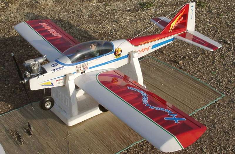

Got the wing all finished with servo and landing gear and all.
Looks quite smart with the red and white colours.
Although I mentioned some quality issues, at least the wing-fuse fit is 100% accurate from all angles.
But why are the wing root ribs of different thicknesses on both panels? one is 4 mm one is 7-8 mm. Still - a perfect fit between both panels and wing to fuse.
OK, on to the rest of the model now.

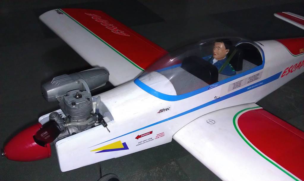

Only the tail servos and Rx to install and we're ready for takeoff.
No further problems, but I'm using an OS46FX which means I have to place the Bat behind the servo tray to get it to balance on the front CG location. Good enough for testing.
Haven't used the spinner though, it weighs a ton!
May eventually replace the engine with a 40 LA.
Currently the weight is going to be 2450 gr dry, ok for the size of the model and engine.

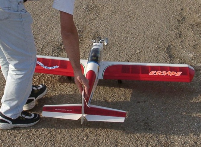

Well, basically the model is finished, with all my extra work of doping the RC bay and tank bay, changing hardware etc., I still can say that I opened the box Friday late afternoon, and the model is flight ready Saturday evening, and no, I didn't work all night at all.
I plan to fly it end of next week.
In summary so far I'd say the following:
Quality is not outstanding at all, it is down to a price.
It is acceptable I guess for this type of model/price/etc.
It is probably better than previous VMARs from what I've read.
All the stuff I replaced I had at home, but it should be added to the total cost really.
While quality and materials seem rather cheap, it is very accurate. Tail surfaces, wings, everything fitted dead accurate with no need to sand anything, that's why I got it assembled so fast I guess.
It looks quite cute, even spinner-less.
Comparisons:
It doesn't even come close to a kit built or scratch built model, but how many ARFs do?
The only other ARF I ever assembled is Hangar 9's Solo Trainer, with my son, for him to train on.
I consider the Solo better quality, and it has already flown some, it flys superbly in my opinion.
I guess it is also a matter of price. I paid about 140 US$ for it in Israel, at my LHS. I do not think it is worth more than that. The aforementioned Solo cost me about half of that, and I consider it was better value for money.
But, I wanted a sport aerobatic model for my FX 46, and wanted it quickly, I also wanted to try an ARF.
Would I buy another one or recommend it to others? Well depends how it will fly, and at what price you can buy it.
Check in a week or so for a flight report.

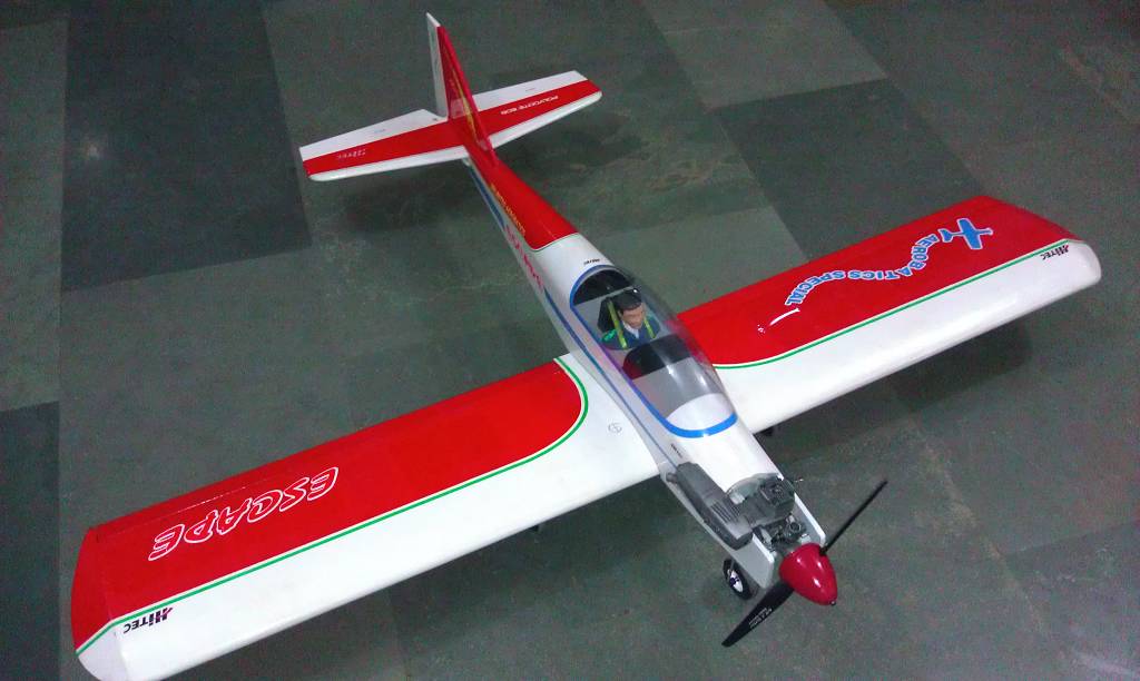

OK, so as promissed here's an update following the flight tests of my new VMAR ESCAPE:
Quite simply - this model flies superbly!
I cannot fault any flight characteristic!
It is very easy to handle, aerobatic, very very smooth and predictable, quite simply a beautiful flyer.
I recommend it as a second model with no hesitation.
I recommend the dual setting up of the controls as per the instructions, it is simply one great flying model.
Low rate makes it a mild aerobat, very easy for low time pilots, high rates make it more aerobatic for more advanced and quicker reactions.
I had some issues I did not like in the assembly, but the bottom line is - the model is an excellent flyer!!!

Just a few more updates:
I have flown my ESCAPE quite a lot during the last weekend, and really am very happy with it.
However, I do recommend more UP elevator throw than is suggested in the manual (though could be my CG) since I felt it a little limited when flaring during the landing. No problem during flight however.
Also, increase the rudder throw to as much as possible otherwise the stall turn is a bit lacking. I increased a bit more than the manual calls for, and then you just have to make sure you really let it stop completely before kicking in the rudder. A little too soon and it looks awful. When you do it at the right moment, the stall turn comes out beautiful.
So far the structure, and covering, and landing gear, are holding up very very well, and this is in the hot Israeli summer sun!

Hello Guys,
I got my VMAR Escape model few days back and i completed the same just too fast. Yesterday it was completed without any hassle.
The only thing i got annoyed was the too much slack on the covering which took me long to stretch with hot gun as the covering did not stretch well even with plenty of heat.
But now it is all done. The overall ARF kit was well built, good hardware and accessories. Looks Great. No Cowl :-(
Nice pilot figure - well dressed !!!
I will soon upload my pictures and review test flight after Sunday !!
Hemal
Hemal
Just finished assembly of my new VMAR Escape 46. Looks great !!
Had my maiden flight last sunday. Was up in the air in few feet. Very little trims. Good for moderate aerobatics. Performed all aerobatics 9 types. Knife edge was not so good as the throw or i would say the control surfaces are not large.
Overall a lovely bird.
What's in :
VMAR Escape 46 ARF Kit
O.S. 46 AXEngine
Hitec Aurora 9 Radio
Hitec Optima 2.4G - 7 channel Rx
Battery :NiMH 2700mA 4.8V (placed back to Servos)
Servo :Hitec Digital HS5845Karbonite gears - 3 nos.
Throtle :Hitec Standard HS325
Prop :Master airscrew 3 blade 10x6
I am modifying to increase the control throws. and will try again soon.
What's in :
O.S. 46 AXEngine
