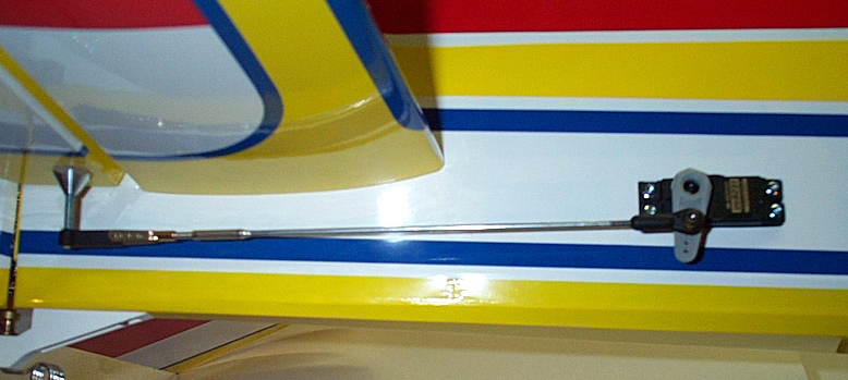

Hi,I'm wondering if anyone changed out the elevator linkage.It seems to flexible.I would think it would flex under load in the air.Has anyone flown one yet.Other than the long linkages for the elevator it is a very nice plane.

I changed out all of the hardware for 4-40 rods and ball links. I am thinking of even changing the elevator rods for Central Hobbies carbon rods. I have not had a problem with the 4-40 rods though. I fly it as a pattern practice plane, so don't have 3-D throws setup on it. The plane flies great except that snaps are very hard to stop accurately. It likes to over rotate.

I'm with you ual767.I just think they're to flexible even though they claim he has many flights on the stock setup.Nothing wrong with overkill on linkage setups.
