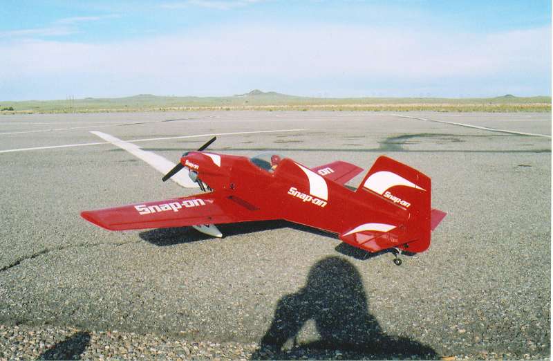

Mine in the photo here was originally the white version. I bought it about 5 years ago. I have OS 1.08 up front . Very overpowered. The white versions was a nightmare to keep up with. After I flew it a couple years, I stripped it and recovered and changed the location of the gear. As you can see the top is all red but the bottom is all white
If I had to do it again, that 50th anniversary yellow would have been the smarter move. I don't really care for the tiger striped one. To get the most out of this thing, consider a .90 size 2 stroke or Saito 100

A Saito 100 is what's going in my plane. From the pictures, it looks like you enlarged the vertical. Any other mods that you've done or would suggest? How's the hardware that comes with the plane?

The control horns and the and the clevis's are okay. Keep an eye on the horns, I think the rudder is a hair smaller. I would get rid of the metal rods, I replaced my elevator rods with 4-40 to avoid bowing. I also changed the plan and ran dual elevator servos to the back. I simply widened the slot and stuck the rudder in the middle and the elevators on either side of it. I like having a solid back end.
3-4 years ago, some guy had his in one of the magazines-RC report or something. He changed his gear and change the stab for better stability. I liked it so I did the same and after I got done rebuilding it. It actually flew better. Before that it was a bit of a pain. Not bad but just a bit. This thing lands very hot and does not like to slow down. I keep my approachs on the lower side of normal to help

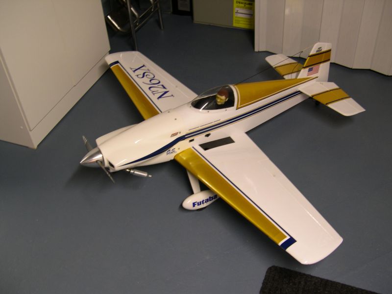

I bought a Midget Mustang with the white with blue trim. Took all the blue trim off (came off easy) except for the painted cowl. Then I added my own trim scheme.
