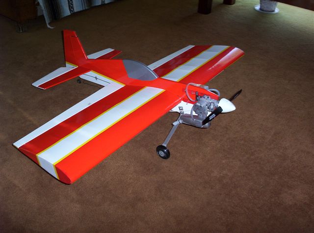

I did some computer repair for a guy not long ago and traded the labor for a ThunderTiger "FunTigerExtra300 profile. I included a pic in case it's a differant plane and someone notices. That's what he said it was anyway.
Flys great but is nose heavy. I've kinda been using it for a break-in plane for new motors. I put a new OS .46AX on it yesterday and that helped. Just hate to add tail weight,,,,,,,but I guess knowing the correct CG would help me out bigtime guys. Anyone ?

The cg range on mine was 4 3/4 to 5 3/4 . I had the tt g-200 arf - both about the same airplane. My cg was 5 1/2 - it was my old beater until I replaced it after 4 yrs.
