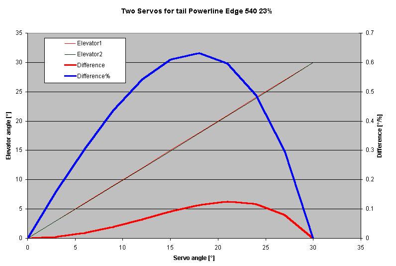

I also did calculation what would happen if you move servo more than 30 degree - the difference is increasing rapidly. A couple degrees difference at 50 degree deflection. However I don't expect my elevator to move more than 30 degrees so I'm very cool.

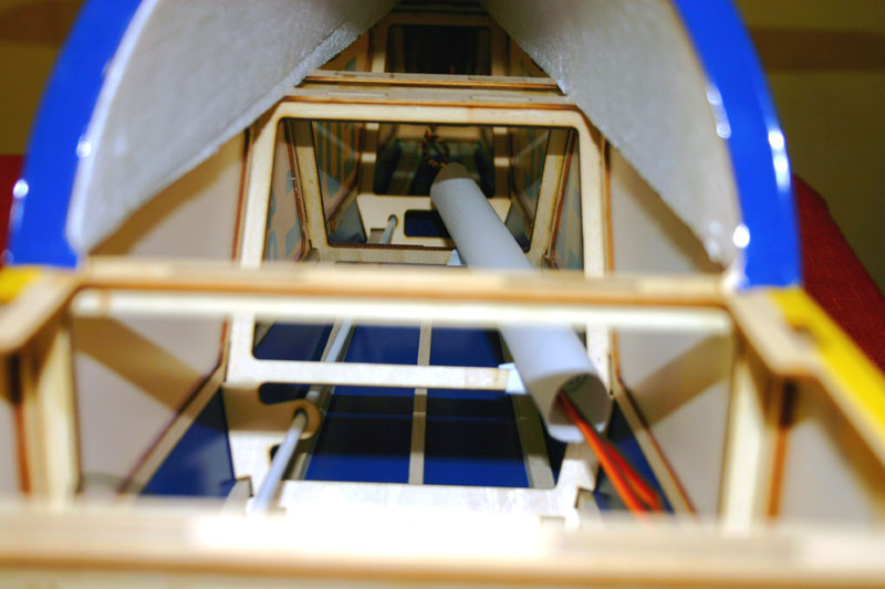

I'm finally back home.
I mounted tail servos without any mods. I'm going to use my own pushrods - twice lighter than stock.
I found, that tail servo wires with 24" extensions are bouncing around the fuselage so I made simple paper tube glued in the tail part. It added 3 grams but wires stay in one place. Se the picture below.
I also got CF tube from CST. it is 3 ft long 21 mm OD and it cost me 52 bucks. I wrapped it in blue paper masking tape - couple layers to get nice fit. Then I painted all with gloss clear dope. After it dries I will sand it with 600 - 2000 paper to get smooth glossy finish. It will fit even better than original one. Now tube weights 108 grams (paper added 18 grams to 90 grams CF) but as I will cut off about 10 inches (wing tube is only 26 inches) My new wing tube will weight less then 2.8 oz (it is about 3 oz less then original one).
Below there is a picture of the new wing tube (not sanded yet) next to the stock one.
Stay tuned
RysiuM

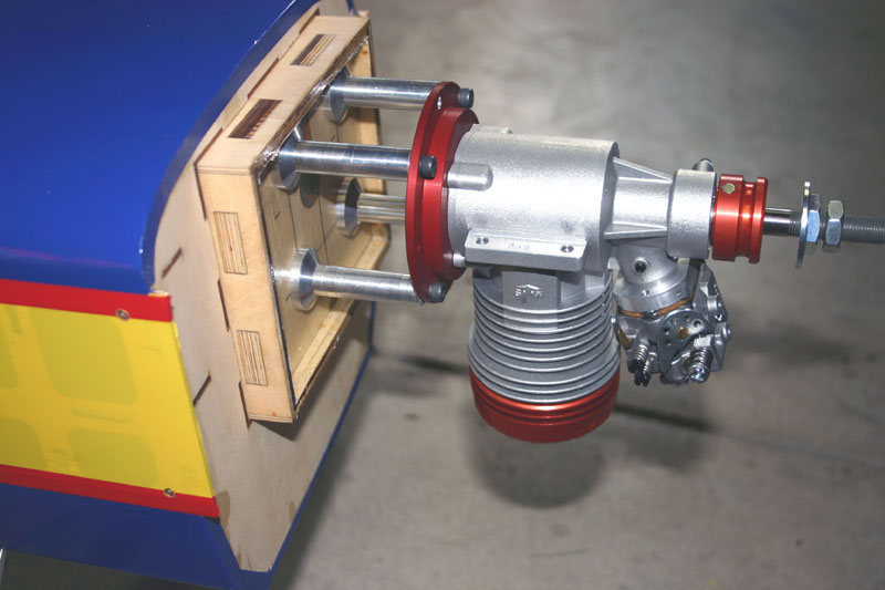

Engine plate weights 2 oz and 4 stand-off are about 2.5 oz.

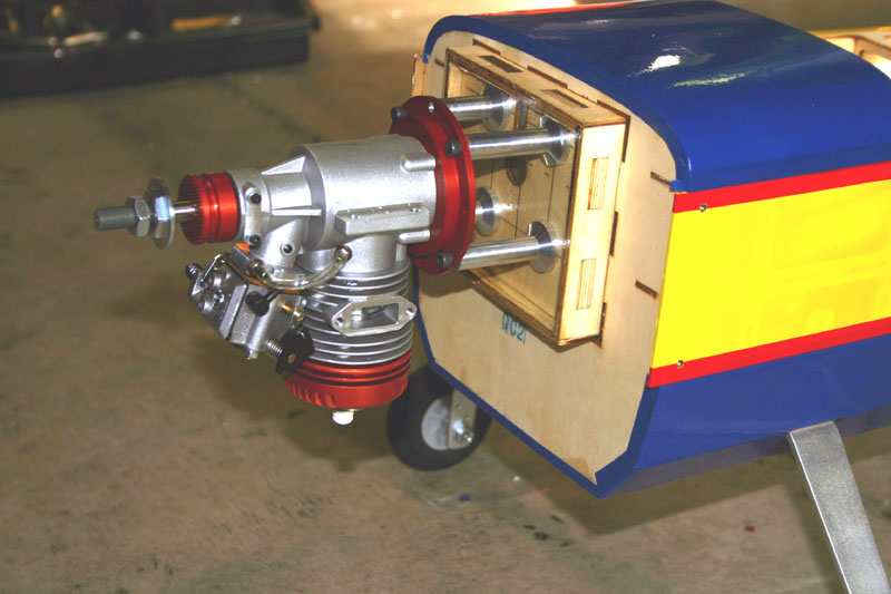

1. Radial engine mount came (thank you, Pe')
2. I finished my custom stand-offs. I weighted them and all 4 are exactly 2.5oz. They are 50 mm long, 12 mm thick with 25mm base. 4.8mm hole through for 10x3 screw. If I measured right the most forward position of the engine will be 7 - 7.5 inches in front of the firewall (the most forward position of the cowling). I need to fit all parts together. The sliding box will help a lot with fine adjustments. This is very clever idea.
The engine thrust line is built into the engine box - my measurements show about 2 degree right thrust. Center of the engine mount is already marked too (horizontal and vertical line). Vertical line is 5.5mm to the left of the fuselage center. I calculated that at 7 inches from the spinner's backplate to the firewall the offset should be about 6.5mm. I still need to verify the horizontal line if it lines up with the cowling. I might move it down about 5mm to accommodate motor better as I'm afraid that the bottom of the engine and the muffler is to close to the top of cowling (engine mounted inverted).
RysiuM

I'm still impressed with the idea of sliding box. I can move it out or if I need I can move it inside (behind the firewall). I don't want to shorten my stand-offs (50 mm) as this is exactly the space I need for ignition module. I will not glue the box until I have cowling cut out and mounted. So I can adjust the engine to the cowling not like it used to be cowling to the engine.
I didn't have much time today, so I only put a blind nuts and I laminated the entire front of the box with one layer of glass cloth and epoxy. This way my mount will have hard surface to stay on. Otherwise under vibration they would cut into the wood. I did the same on my H9 Edge and the mount is solid like new.
The good thing is, the weekend is coming
- more time for building and flying (if the weather stays as good as it is now).RysiuM

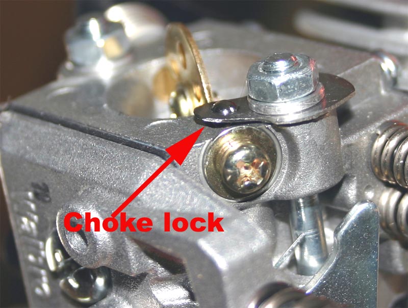

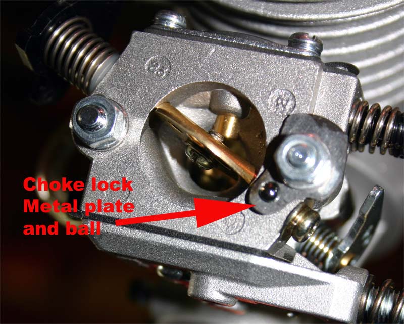

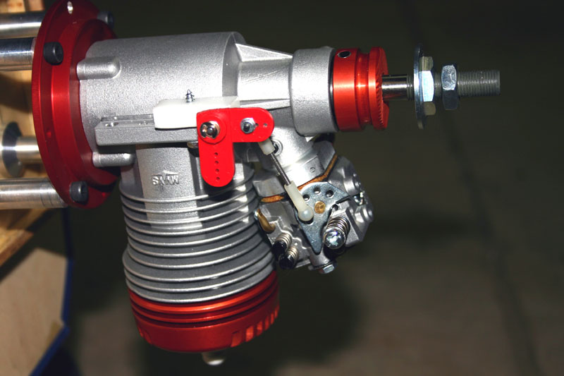

I solved the choke problem today. I went "hard way". I drilled two spots on the choke shaft through the hole (do0n't let any chips to get into carb): Choke fully open and fully closed. Than I made a spring plate 0.35mm - thickness gage is made of very good steel
. I drilled two holes: 6.25mm (for carb screw) and 3mm (for ball) 6.3mm apart. For locking I used 3.25mm steel ball (from some old ball bearing). It works very well. Even with the spring hooked the choke can be lock in the closed position.
It was not difficult at all.
So here are the pictures of my new Choke-lock.

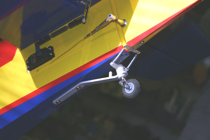

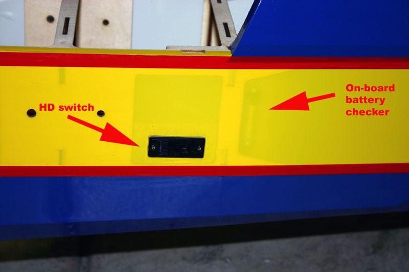

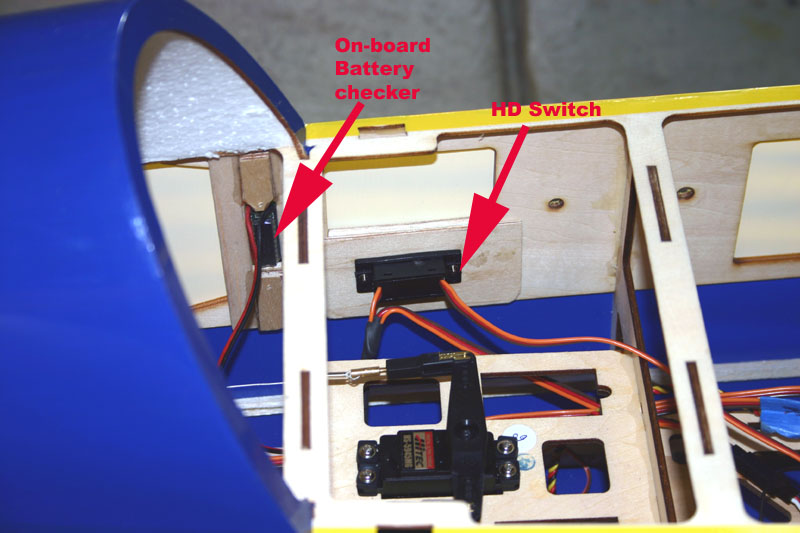

I missed some pictures, so here they are:
1. Tail wheel - the brace is Great Planes the rest is Powerline
2. Heavy duty switch and On-board battery checker. I set it for 7.2V (6 cells) - if voltage drops to yellow it means the battery voltage dropped below 6.8V 3.4V per cell). It is under load so the battery will have enough juice to finish the flight.
3. You can't see the battery checker, but when it's on it lights through the covering.
RysiuM

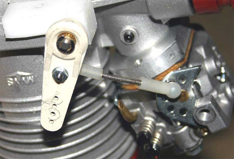

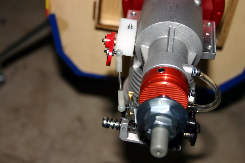

The last one for today. I designed throttle linkage. I might extend the arm of the bell-crank to increase resolution even more. Right now the full travel is 1/2 inch. As I have zero slope on the bell-crank (it has bushing taken out from CR-ROM motor
) I want the best resolution on the linkage as I can. I will have slope on the servo linkage because the cable needs to be quite long.
Pictures attached.

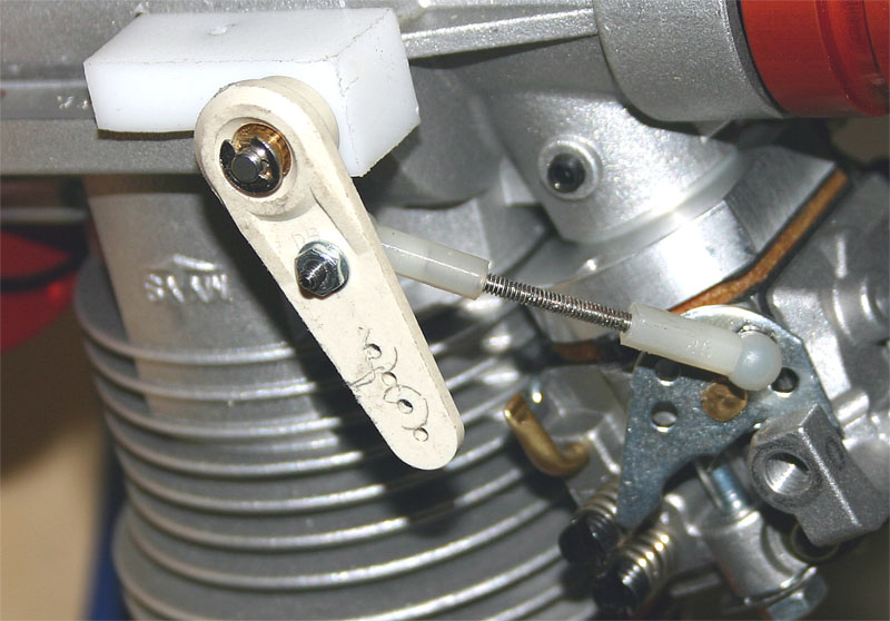

I was walking around it for whole day and finally made my mind. I redesign and rebuilt the whole throttle connection. This time I used glass-filled HD servo horn. The benefit of new designs are:
- This arm can withstand heat from the motor,
- It is longer so now full travel is 1 inch.
- because it works at different angle now I have some kind of mechanical expo near the idle. This will give me better precision at low rpm (because it is mechanical on the throttle arm it is not sensitive to the slope on the cable or servo).
I think this is final.
Pictures at idle and full throttle, and from the front.
RysiuM
