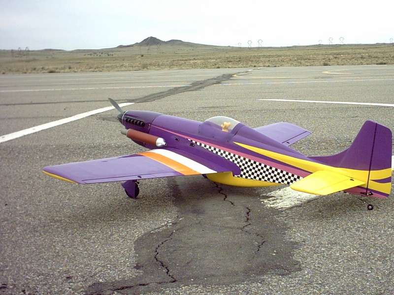

Went off real good this morning. With that G2300 up front, lack of power was not an issue. Did not need much trimming at all. A bit of aileron and elevator and that was it. I am running a 14/8 on it and was going real well. So I'll leave it on for a few flights and then switch to a 14/12 or 14/14 apc to get it going.
Landing was good but fast which was all my fault. Those Kavan wheels helped slided it on around when the end of the runway came up quick. Only bad point is that color. its worse to keep track of than my little Miss America. So I am going to put a big white stripe out on the edge of the wing to help keep an eye on it in the corners.
So, for some of you who bought this thing on ebay, I am impressed.

Glad to hear all went well and it flys nicely!
What was the final weight ?

Weight? Ah, I dunno! Hadn't even thought of it , Let me go check here. Looks like a hair over 8lbs. I did add a bit of tail weight in the back of the air scoop.
Bob, you know you ought to get Dub to redesign or make some kind of an "add on" to change the direction of the exhaust from blowing straight out all over everything to a bit of an angle. I know they make those plastic/rubber deflectors but they look bulky and stupid.
Overall, this was a definite thumbs up on the plane. Maybe next flight I'll try the flaps.

You got that off ebay??? Is it a cheap chinese arf??? Whats the wingspan??[sm=RAINFRO.gif]

Well back in the beginning of February there were a bunch of these planes on ebay,so I took a shot at it and got it for $160. I just took a look and don't see any but the seller who is apparently some sort of a distributor sold a bunch of them. It is a 65" wing or about the size of the H9 Marie. It has retracts , flaps and the covering is dead on the colors of monokote. There is no name no place or anything other than a arf in a box the build was fine.
I thought the overall quality was as good as WM and I have a few of those. The quality is above most of those chinese junkers and half a dozen other brands , just no idea who made them. If you get a chance to get one, You ought to take it, shoot even the horizontal stab is like a real airfoil, not some flat wood thing.
I beefed up the firewall and retracts blocks. Up til now , I am impressed but thats all i can tell you about it.

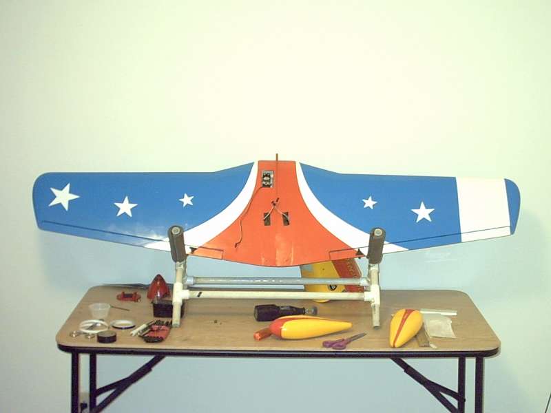

Which color scheme did you get? I have the Miss America in the .40 and GS from WM. The little one is a pain for me to keep track of, so I stuck a white stripe on it and helps

My WM is also a Miss America. I haven't had trouble with the color, but I've only flown it 3 times. The clone is one of the silver ones. I may need to do something to make that one easier to see.
