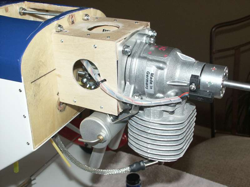

The landing gear and wheels are garbage. Plan on replacing both. I had a set made for the CAP at TnT landing gear so they should have the pattern. Make sure you get them to make it from 3/16 or 1/4 " aluminum not 1/8!! The first set I had made were too thin and they bent just as easily as the stock gear. I eventually "doubled up" the stock and TnT gear and that finally fixed the problem. Had I used 1/4" gear in the first place it would have worked great
Trust me, don't even consider the stock gear by itself... I never had a hard landing it still flattened out. I was bending and re-bending nearly every flight. I must have had the gear off 10 times in the first few weeks. If you hit it hard and you will be fixing the wing where the wheel pants go through it when the gear pancake on you. It was a different plane once I fixed the gear. All of the SuperKraft planes suffer from horrible gear sets.. the rest of the plane is fantastic... just lousy cheap Chinese aluminum.
You will also have to reinforce the firewall with fiberglass AND tie it to the second former with some 10-32 all-thread. If you only glass the firewall and do not use the reinforcement rod - the firewall will separate at the top side where it meets the fuse. Mine had significant cracks only after a few flights... the cracks would widen when the throttle was advanced... not good.

desertpig,
Do you by chance have a pic of the all reinforcement using the all thread. I have a good idea what you mean but for the life of me I cannot picture it right now.

My Feedback: (61)
bubba -
Here is a pic that I have the shows the reinforcements ... along with the crack that started prior to putting in the rods. The whole thing took about 5 minutes to install.

Thanks DP,
Mucho Thanks for the pic [sm=thumbup.gif]
That helps allot. I never thought of building an engine box. I just used standoffs but I will definitely do that all thread mod, that's a great idea. BTW...TNT does list the aluminum gear so I orded that. I was hoping for CF but I'll take anything other than the stock crap...

My Feedback: (61)
I originally started with square wood standoffs, but felt there was a little too much flex in the mount so I glued 3/32 plywood to the standoffs to form an engine box. I wasn't trying for the box at all and would have rather not had to add the weight but I did not have time to wait for custom aluminum standoffs.. so that is what I ended up with. Worked great and it was very strong.
I am sure aluminum standoffs would work fine.
