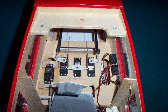

H9 Taylorcraft. The width of the holes in the servo arm and control horn are the same size. The set up works great and it hardly cost anything to set up.

Tim I agree with what you are saying as long as you use Pulley's not arms. With a pulley the belt always leaves the pulley 90 degrees to the center line, not so with arms. As a control arm travels through its ark the amount the push rod {or cable} travels is NOT linear. The rod will travel more per degree of rotation at 90 degrees to the center line than it will at 45 degrees as you stated, if the rudder arms are wider than the servo arms the distance between the cable pivot points will not remain constant and one side will go slack, if the servo arm is larger than the rudder the cables will turn into guitar strings. I agree that I would not be concerned about a loose cable, but a tight one......I gotta think about that when I'm awake. :^}
I really like your set-up :thumbup:
