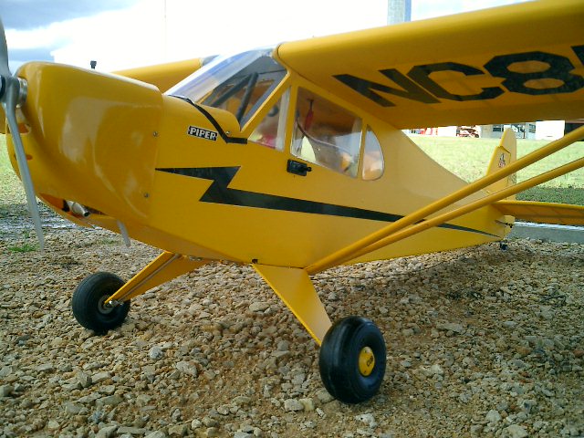

I have the GP 81" fabric covered Cub. If I could go back and change things, I would have gone with the WM 84" one. Less expensive and more wing, might be what's better for that 91FS engine you have. Just a thought. Cubs do look sweet in the air. You won't be disappointed. Good luck.
